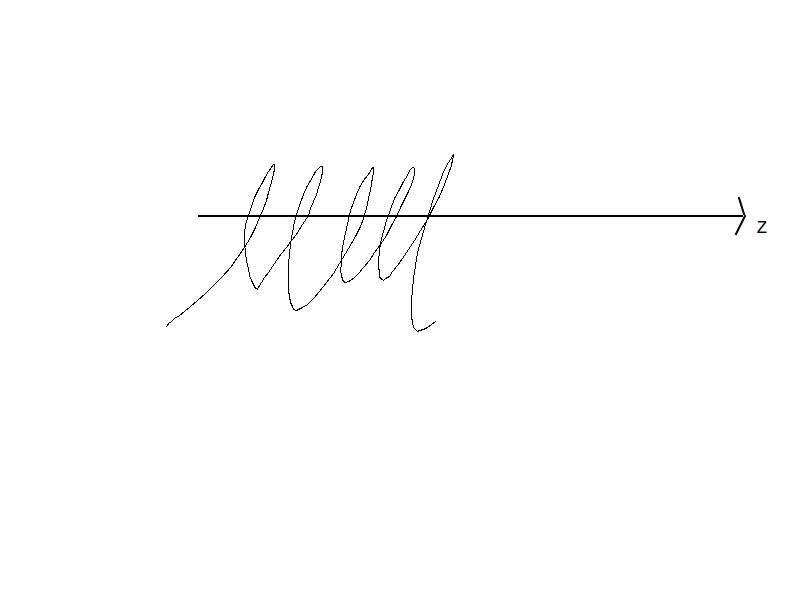

What would be the best method to model a solenoid? I tried writing a program that calculated the off axis elements of the solenoid but the value came out wrong. Any idea?
What do you mean by "off axis elements"?
I drew up a quick diagram to show what I mean.
The on-axis elements (along the Z-axis which is located along the center of the solenoid) can be calculated via some method. Ampere's law possibly? However, what would I have to do to calculate the values which are not along the Z-axis?
There are a few different methods that can be used to model a solenoid, depending on the specific parameters and desired level of accuracy. One common approach is to use a mathematical model, such as the Biot-Savart law, to calculate the magnetic field produced by the solenoid. This can then be used to determine the off-axis elements of the solenoid.
