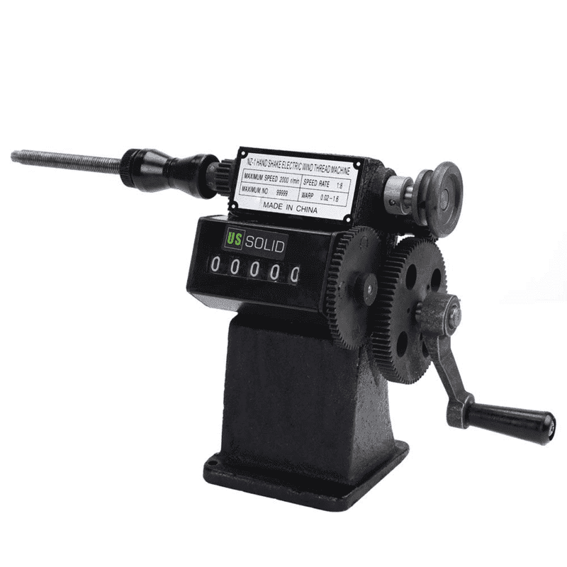

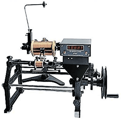

BTW, for winding good quality solenoids and transformer coils at home, consider purchasing a simple coil winder. They are fairly cheap, and are definitely worth the investment if you are going to be winding many coils for your experiments...
https://images-na.ssl-images-amazon.com/images/I/417FOYheouL._AC_.jpg

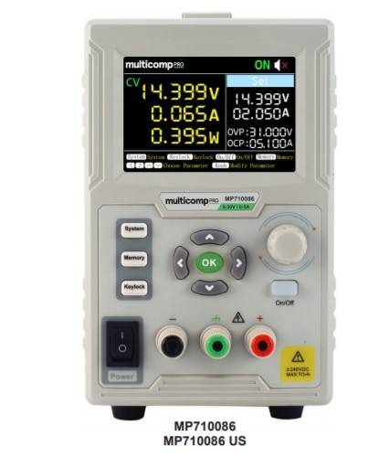

A variable voltage current limited power supply is very nice to have for this sort of tinkering. This is one that I built back in the 1980's, and still use. It uses an LLM317 1.2 to 12 volt linear regulator.
And this one, which I ordered yesterday, should be much better: https://www.newark.com/multicomp-pro/mp710086-us/power-supply-bench-prog-1ch-5a/dp/42AH0483?ost=42ah0483.
