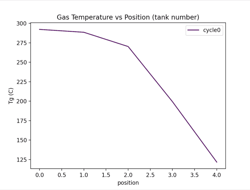

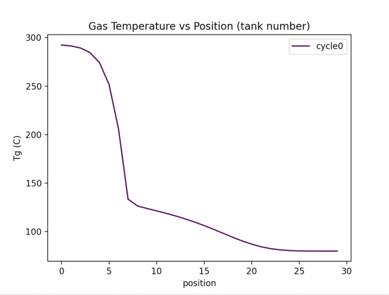

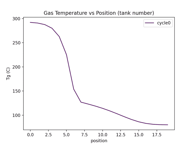

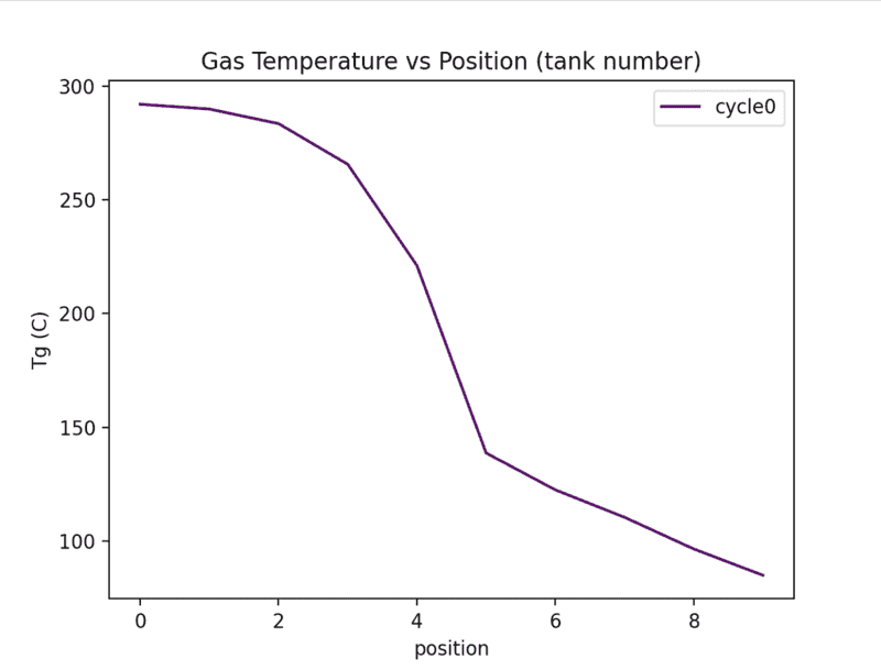

Hi Chet, my apologies for the delay. I was running a few simulations for various values of n. Anything greater than n=10 takes considerable time now. n=30 took 24 hours actually.
Anyway, I wanted to do a 'grid independence' study of sorts. If you run hot air through the bed for x amount of time, we get a thermocline in the bed. I did this for n=5,10,20, and 30 and here are the results. Clearly increasing n results in a 'tighter' thermocline or a sharper drop from high temperature to low:
n=5:
n=10:
n=20:
n=30:
I'm running higher n now (n=100) however this will take a few days. The goal of this analysis is to 1) find the value of n where the output plots stop changing i.e. grid independence and 2) to quantify the losses in the bed across a charge/discharge cycle i.e. if we discharge for 100s and then charge for 100s, how close to we get to the original temperature profile?
No questions on this, just updating
I think they will continue to change as you increase n. Our idea was to calibrate the value of n to the actual data on column operation to match the actual amount of dispersion occurring experimentally.
  • #422
Are you saying that you don't think there will be a point where increasing n no longer changes the output i.e. grid independence?

  • #423
Yes. Or, more precisely, the temperature profile will approach a step function at large n.
