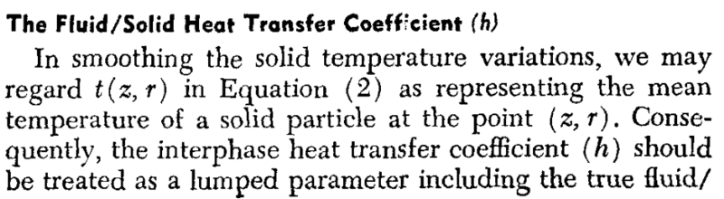

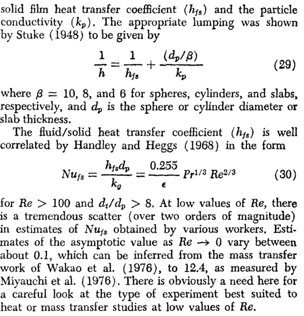

Just as a side note - I have found a few papers that talk about Nusselt number correlations. This is obviously closely related to the actual U value, so if there was a way to convert Nusselt number to U value then we could use that approach. The only equation that comes to mind is ##Nu = \frac{hL}{k}## however again this is in effect splitting the U value into conduction and convection it seems
Final update on this - I just found a paper that does lump convection and conduction for two phase flow, and it seems to do it in a way that would slot nicely into our model. Here is the section on lumping h and k:
Does this look suitable to you? If it is then I can code this, it looks straightforward
Link to paper if you're interested (actually a very nice paper): https://aiche.onlinelibrary.wiley.com/doi/abs/10.1002/aic.690250413
Also as a note, the Prandtl and Reynolds number will not be constant, meaning that U (or h in this model) will not be constant across the system

Yes. This is what I had in mind. That reference looks a little old, so maybe you can find some more recent work that could be even more accurate.

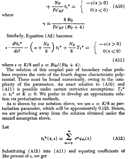

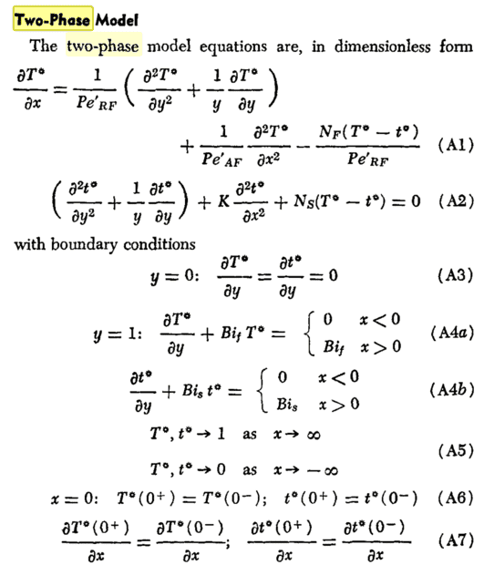

Hi Chet, back working on this model this evening. I will be working on the Nu vs Re plots (the U correlation) first thing tomorrow. Will update here with results.
I was curious - now that we seem to be out of the woods on this model, do you think there is value in taking an existing model and recreating it?
For example, the paper that provided the lumped heat transfer coefficient correlation seems to provide a two phase model also. I'll link the paper below, however these are the model equations:

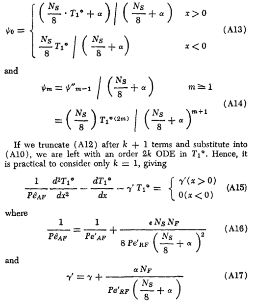

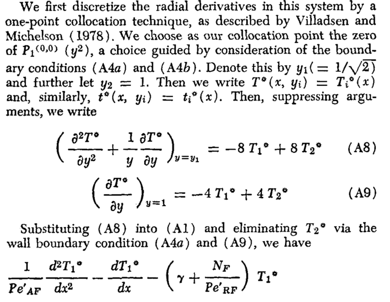

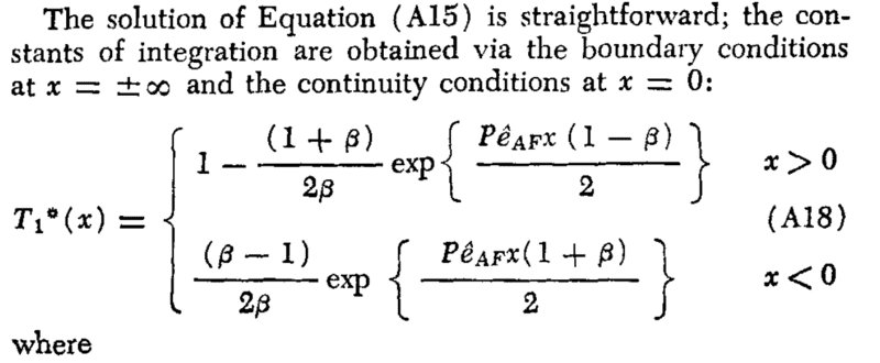

Link to paper: https://aiche.onlinelibrary.wiley.com/doi/abs/10.1002/aic.690250413
My question is just do you think there is value in either:
1) comparing this model with the model you developed in this post
2) replacing our model with this one

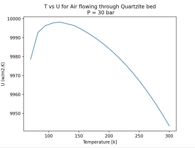

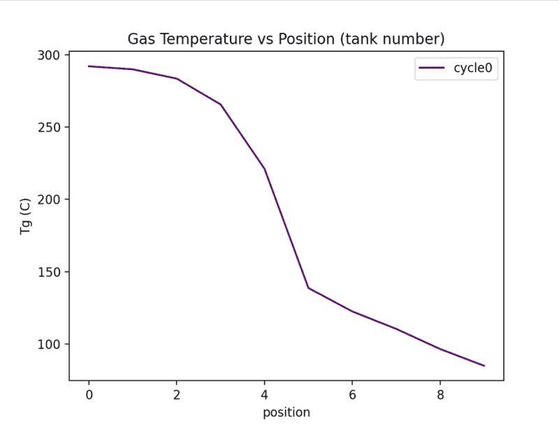

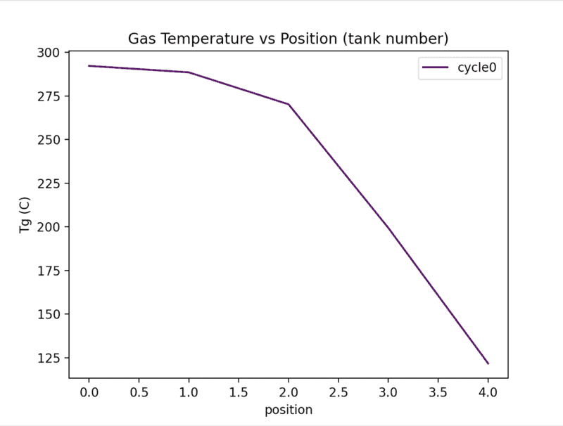

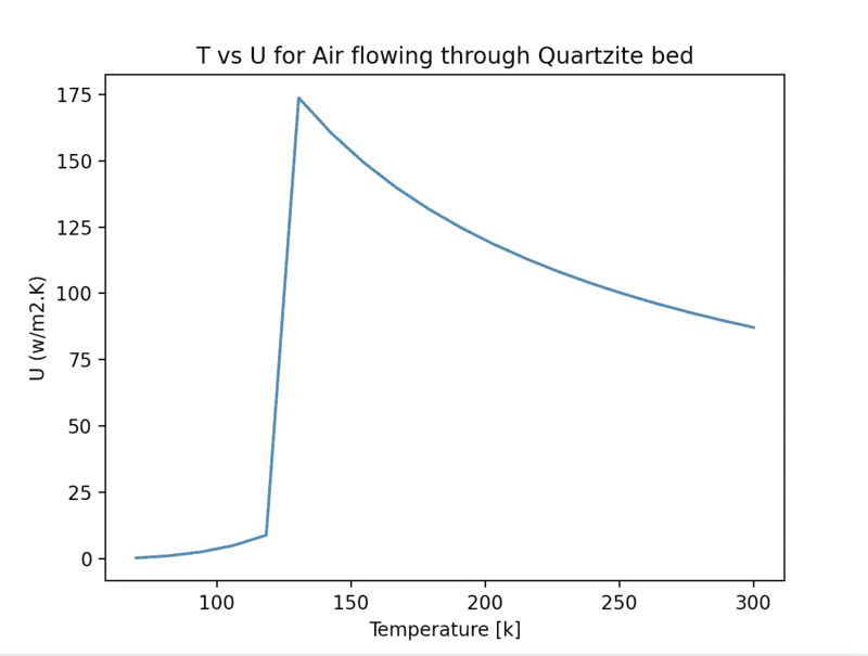

Hi Chet, plot of T vs U using the above reference. Looks like U will vary from 9970+/-30 across our range of temperatures (I thought this seemed high so I checked it versus some known values and it looks ok) :

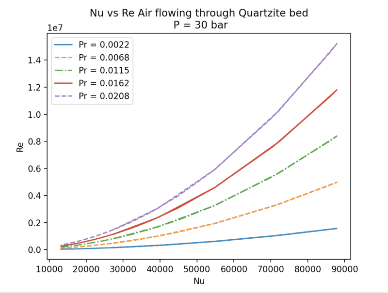

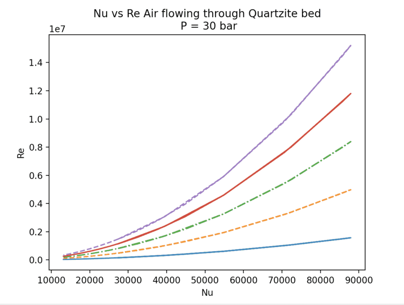

In addition, here is a plot of Re vs Nu for some constant values of Pr. I checked the range of Pr values we got for the above plot, and just picked 5 evenly split across the range of Pr values. Here it is:
If the above looks ok to you I'll include this U functionality in the main model!
These are very large values of U. Are you sure of this. why is there a temperature dependence.
casualguitar said:
In addition, here is a plot of Re vs Nu for some constant values of Pr. I checked the range of Pr values we got for the above plot, and just picked 5 evenly split across the range of Pr values. Here it is: View attachment 297154
Is this from the Bird et al correlation? How are Re and Nu defined in this? Why are the Pr numbers so low? Did you also include a heat transfer resistance for inside the packing, like that other article I referred you to? The BSL correlation is only for the gas phase.
Please show the equations you used for this, and the comparison of the various correlations available in the literature.
You have provided me with inadequate information to arrive at a confident assessment of this.
I will check these. The temperature dependence comes from the temperature dependent parameters in the Pr and Re equations (shown below)

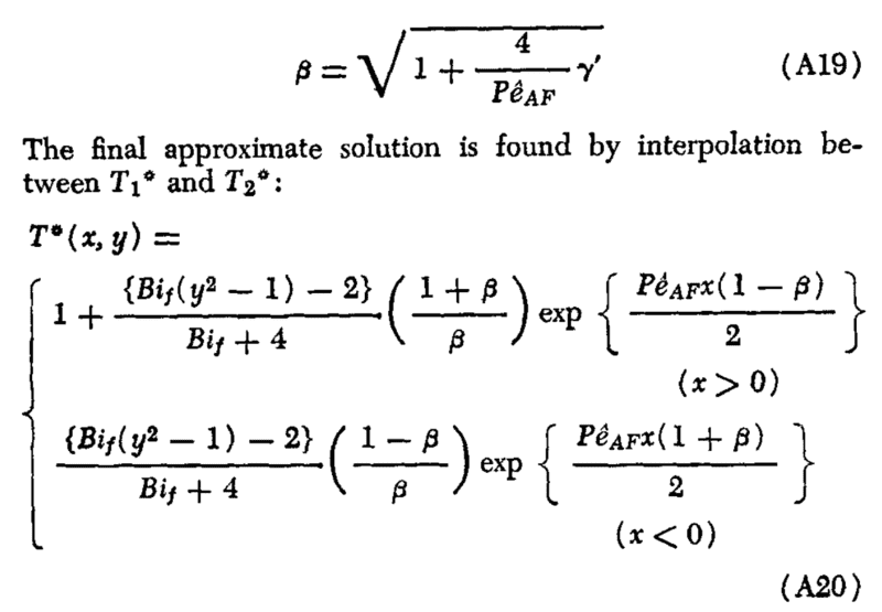

No its not from Bird et al, its from Dixon et al: https://aiche.onlinelibrary.wiley.com/doi/abs/10.1002/aic.690250413

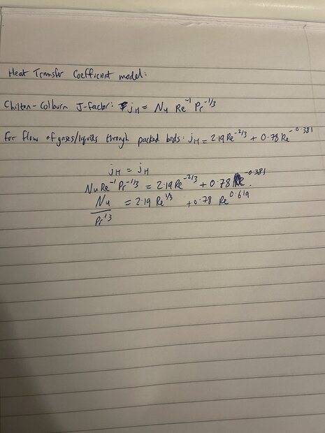

The heat transfer coefficient model from this reference is this:
The Reynolds and Prandtl numbers are defined as:
Where k is the fluid thermal conductivity and G is the superficial mass flow rate. I checked that I was using the right units for these.
So the temperature dependence comes from the temperature dependent parameters (heat capacity, thermal conductivity of the fluid, viscosity of the fluid). Having these parameters as non-constant only seems to affect U by <0.5% anyway
So I will check the U and Pr to see if I've made any errors. Also to your question about having internal packing heat transfer resistance, I haven't thought about this. It doesn't seem to mention it in this reference, however it looks like this is the second term in equation 29?
Thanks and I'll get to checking the U/Pr calculations
In terms of the Nusselt number and Reynolds number definitions in the BSL correlation, the Dixon et al correlation reads $$\frac{Nu}{Pr^{1/3}}=\frac{2.55}{\epsilon(1-\epsilon)^{1/3}\psi^{1/3}}Re^{2/3}\tag{1}$$where ##\psi## is a shape factor very close to 1.0. The maximum value of the term involving ##\epsilon## in this equation is 0.47, which corresponds to a minimum value of ##Nu/Pr^{1/3}## of: $$\frac{Nu}{Pr^{1/3}}=\frac{5.4}{\psi^{1/3}}Re^{2/3}\tag{2}$$This compares with the BSL correlation of $$\frac{Nu}{Pr^{1/3}}=2.19Re^{1/3}+0.78Re^{0.619}\tag{3}$$I'm going to prepare a log-log plot of these equations to see how they compare for a typical range of Re for packed beds running from 1 to 10000.
The blue curve is Dixon et al correlation with ##\epsilon=0.75## (minimum curve over all ##\epsilon## values) and ##\psi=1.0 (spheres)##. The red curve is BSL correlation. These are based on BSL definitions of Re and Nu.
The Dixon correlation is 1.8X higher at the lower Re=1 and about 9X higher at Re = 10000. I recommend the BSL correlation which is much more modern, and based on much more data.
Chestermiller said:
This compares with the BSL correlation of $$\frac{Nu}{Pr^{1/3}}=2.19Re^{2/3}+0.78Re^{0.619}\tag{3}$$
Would the first term be ##2.19Re^{1/3}##? As we will have ##Re * Re^{-2/3}##

So to use the BSL correlation, does this mean we would using the Nu/Re definitions in the BSL correlation to predict ##h_{fs}## from eq.30 (post #376), and then continuing to use eq.29 to predict h? If so I can code this up now
Yes, typo. Corrected.
Yes. But the version I gave is better because it gives Nu directly
One point of confusion - does the Dixon version not give Nu directly also via equation 30?
They use different definitions of Re and Nu than BSL
Ah got it, I'll replace the Dixon version with yours/the BSL one
Looking at how you set up your plots, you chose a range of Re numbers. To set up my plots above I actually chose a range of temperatures. I suppose choosing a range of Re values, to get a range of Nu values (at a few constant values of Pr), then subbing into eq.29 is better?
This would seem to mean that I would have to choose a single temperature/pressure value, and use the values of cp, mu, etc at these T/P values, which would assume that U is not temperature dependent. Is that correct?
I suppose I could choose 5 values of temperature (across the 80-300K range), and calculate the Pr number at each value of T. Then use these Pr values to create 5 graphs of Re vs Nu using your algorithm above? Is that reasonable?
The objective of my plot was to compare the two correlations on a common basis. I don't care about anything else.
Eqn. 29 is for use inside the bed/tank model. There is a different U value for each tank in the model. The U value for each tank should be calculated within the bed/tank model. Given P, T, and ##G=\dot{m}/A## for a given tank, you calculate Pr and Re for the tank, then calculate U for that tank. This value of U also varies with time. Use the value of U at the beginning of the time step (end of the previous time step.)
I fully follow this now and can model it. I can get a sense of how U will vary with temperature (at constant pressure) by doing something similar to what I did above except with the new correlations. U doesn't seem to vary all that much with temperature but I will redo these to be sure.
What is the purpose of the Re vs Nu plots? What information can you get from these? I suppose it tells you how convection dominated the heat transfer is, for a given flowrate? Meaning that for our model we would want Nu to be as high as possible, to avoid axial conduction along the bed?
I'll get on scripting U (outside the main model) to see what the approximate range of U values is
It will vary very much with ##\dot{m}_{j-1}##
My only purpose was to see the comparison between the two correlations.
Chestermiller said:
It will vary very much with mj-1
Ok yes I was thinking about that. Given the range of mdot and T values it seems it might be useful to calculate U at some specific points like (max mdot, max T), or (min mdot, min T) etc to see how much it varies
There was a storm here today so we had no power. Back now so I'll get to implementing this
Hi Chet, have I got both the intended computational flow, and correlations to be used, correct here? The only change from he previous version was to include the new Nu correlation from BSL rather than from Dixon et al.
You mentioned your version gives Nu directly, and the previous version I did does not do that. I don't see where that comes into play here. Is this correct?
If the above is correct, then for the approximate range of flow rates the heat transfer coefficient varies from approximately ##50## to ##200\frac{W}{m2.K}##. I'm just providing that range to give an idea of what range of values U will take.
The U calculation is straightforward to implement in the main script. I'll make a function that calculates U(T, P, m_dot) tomorrow morning, and will add this to the main model.
