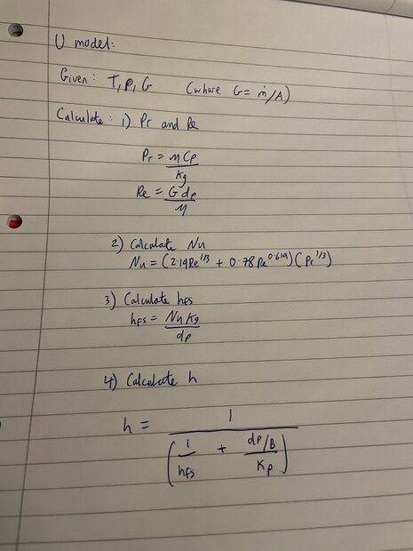

  • #391

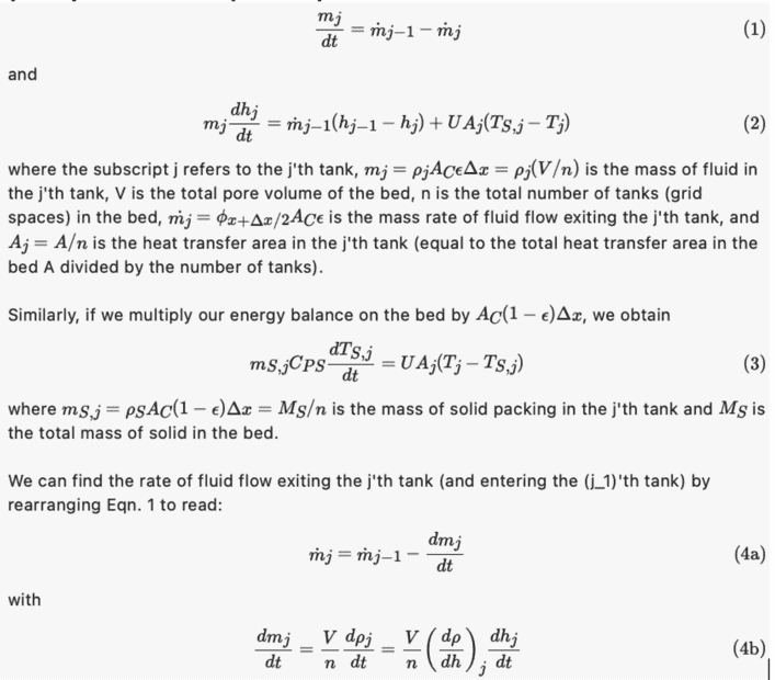

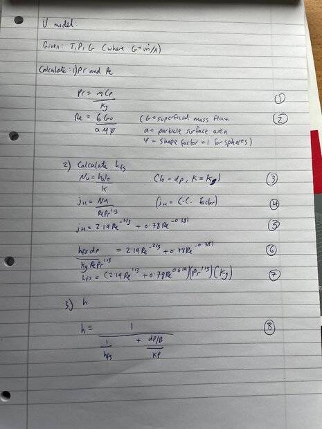

casualguitar said:
Hi Chet, have I got both the intended computational flow, and correlations to be used, correct here? The only change from he previous version was to include the new Nu correlation from BSL rather than from Dixon et al.
You mentioned your version gives Nu directly, and the previous version I did does not do that. I don't see where that comes into play here. Is this correct?
The BSL definitions of Nu and Re are different from these. So, if you use these equations, you will get the wrong answer for the convective heat transfer coefficient.
  • #392
This is the approach using the BSL Re correlation (eq.2, or 14.5-4 in BSL). The Nu definition I used is the same though. This approach does allow you to get. Nu 'directly' as it cancels out as you mentioned. Have I used the correct Nu correlation here?
  • #393
This version is correct, but different from the incorrect version you provided in post #389.

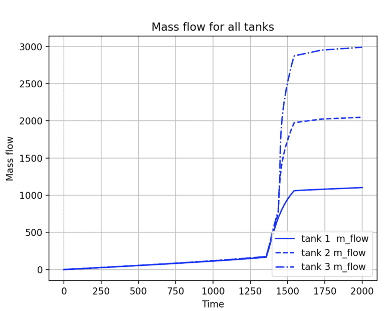

Ok this function is now integrated into the main model. I am getting some unusual output (not because of the new U function, I was getting it before that). My guess its a units thing so I'm going to do a full debug to see what is going on

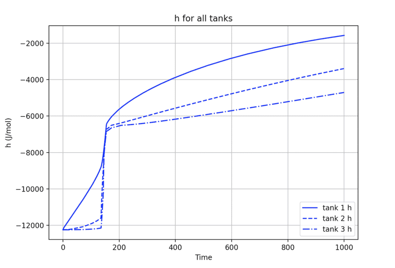

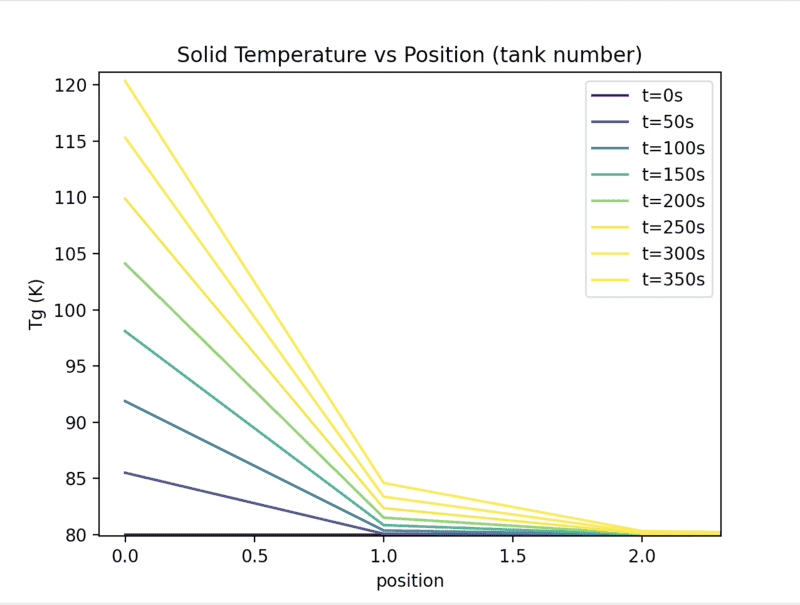

Hi Chet, I've done a 1st debug of the script and these are the output plots, which are definitely incorrect, however I'm sharing them anyway to show where the model is at. The S shaped curves are not as 'nice' as I expected. I think the source of the error is that I am mixing up the ICs/BCs for m and m_dot somewhere, however that's just a guess for now

  • #398
Hi Chet, apologies I'm actually still debugging. I think the bug is in the mass holdup and mass flow rate usage. I'm almost sure I'm not setting up the boundary and initial conditions correctly for these. The reason I think this is because 1) after thinking about it I'm actually not sure if I should use m or m_dot an an initial condition and 2) The plots above show n=1 as being shaped differently to the other positions
Its late here so I'll reframe this as both a question and a clear summary of how I am using m and mdot in the morning

Now that you mention it, eq.2. and 3 have time derivatives, but 4a does not. We can solve directly for dm/dt and m_dot, so would I just need to integrate eq.2. and 3 here? I'm actually not sure why I assumed I would need to integrate 3 equations
  • #403
casualguitar said:
The parameters in the dydt list (in the script) are being integrated w.r.t. time and these are fluid enthalpy, solid temperature, and m_dot (mass flow rate out), which are equations 2, 3, and 4a in the image below (your original equations).
Yes, just two. The other equation is spatial only.

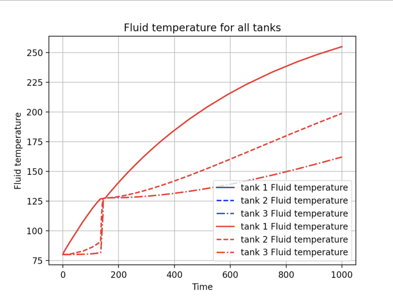

  • #404

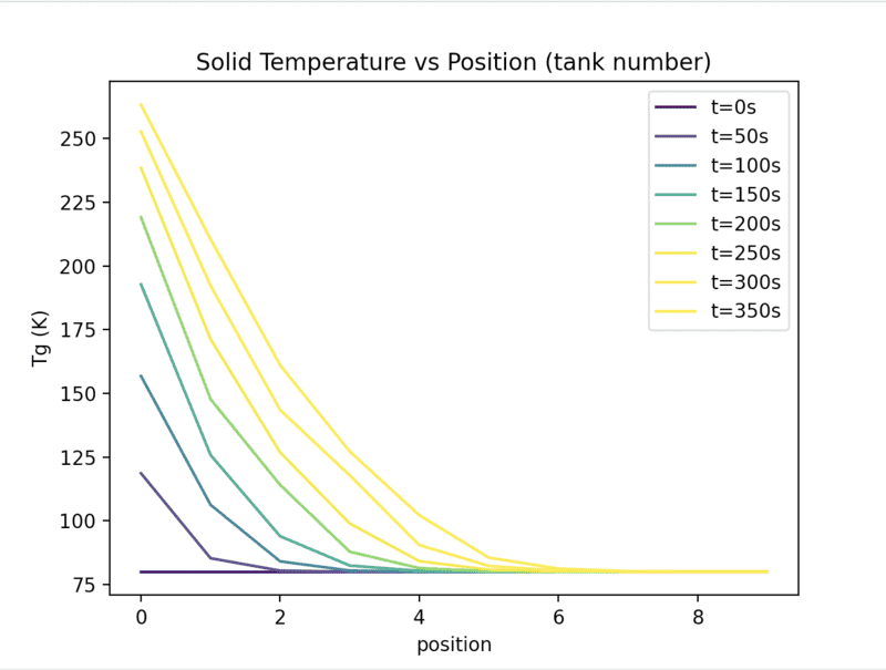

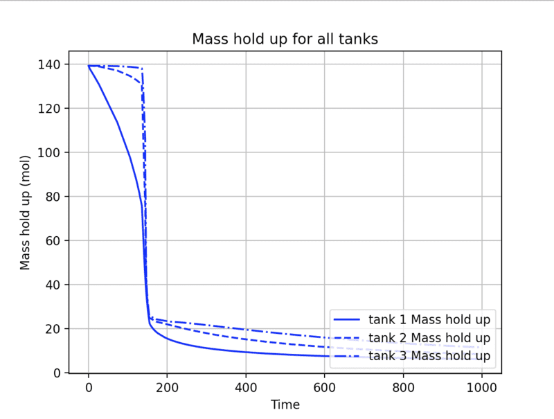

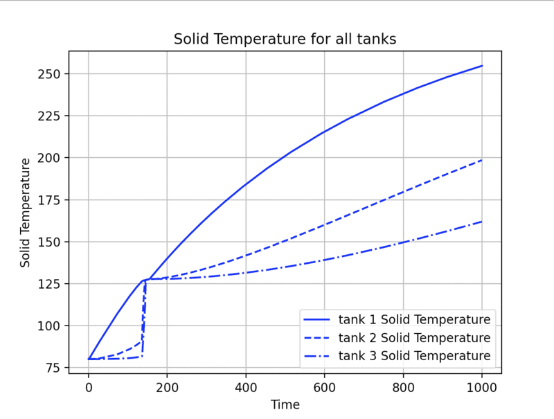

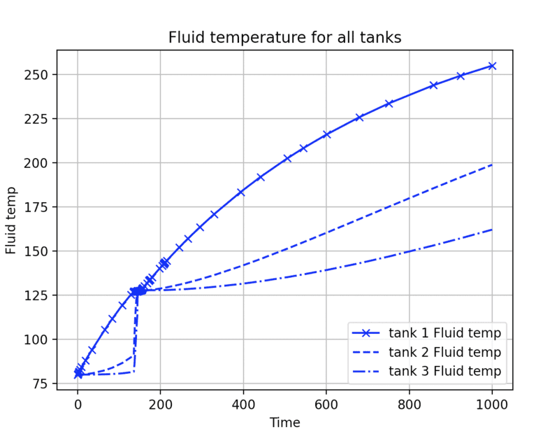

Hi Chet, I have removed dm/dt from the dependent variables (required some small code adjustments to the after processing etc also). The simulation takes close to 10 minutes to run 1000s of simulation time, so this evening I am looking into optimising this code (replacing the nested for loop with a vectorised alternative, etc).
These are the plots produced by the simulation. They are not the 'perfect' S shaped curves I was thinking they might be. Do these curves look reasonable, or do they suggest there are further simulation errors? If the latter, would you have a suggestion as for how to systematically approach debugging?
Fluid enthalpy for 3 tanks:
Solid Temperature:
Mass holdup for all tanks (note mole unit):
Fluid temperature (not reason for red plot here is I used two different approaches to calculate this, just checking that they are equivalent):
The main thing I am concerned about in these plots, is that the plot shape of the first tank is not the same as the other tanks, suggesting that I am possibly doing something wrong in how I am setting up the initial/boundary conditions
  • #405
Solid Temperature:
Check the 1st tank response against the 1 tank model with 1/n the volume.

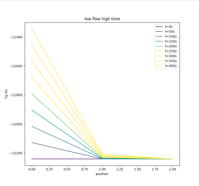

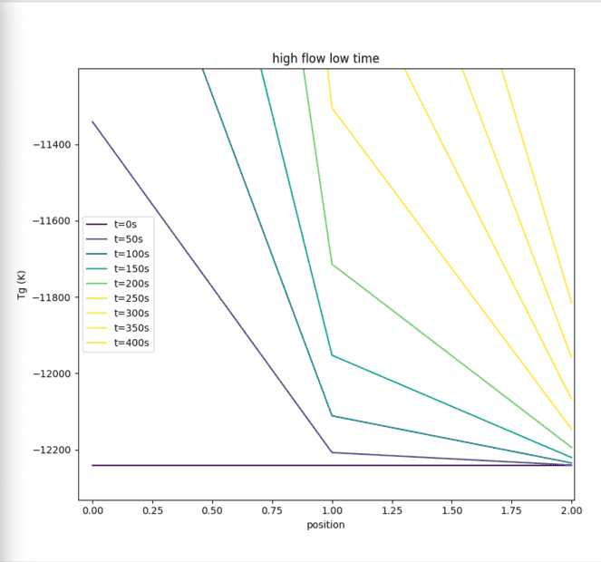

Hi Chet, updating here as discussed. So here is the position vs gas temperature plot for a molar flow of 0.001mol/s, and then below for 0.008mol/s.
The lower molar flow rate allows for a sharper temperature front that I think you mentioned was desirable
0.001mol/s:
0.008mol/s:
Note the 0.001mol/s flow also had n=10, I just zoomed in on the relevant section. But yes as you can see the temperature front is much more pronounced for the lower flow

This is a very difficult comparison because the advance of the fronts is different because of the different flow rates (IT'S NOT ON A COMMON BASIS). Compare the cases on a common basis in which the injected volumes are equal,, and see how they compare. So run the 0.001 for 8x the times of the 0.008.
Ah yes, I didn't think of that (not a common basis)
Running for m = 0.001mol/s and t = 400s, and also m = 0.008mol/s and t=50s gives these plots which match almost exactly:
In addition, these are the final arrays, in the format [h0,Ts0,h1,Ts1,...hn,Tsn] where h is the fluid enthalpy and Ts is the solid temperature. They are almost identical:
So returning to the initial question about which parameters most affect axial dispersion, it seems we can conclude from the above that molar flowrate does not affect axial dispersion significantly?

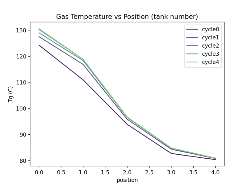

Hey Chet, just in addition, I've got a working 'stopping condition' now. Meaning that the simulation stops once the outlet temperature of the fluid reaches the inlet temperature of the fluid
The reason this is useful is because I can now sort of quantify the beds performance degradation over time (unless I'm wrong) in this way:
1) assume the bed is initially at ambient temperature
2) pass cold air through the bed at 0.008 mol/s until the bed reaches steady state
3) save the time taken to reach this stopping condition
4) pass warm air through the bed at 0.008 mol/s (liquefying it), until the stopping condition is met, meaning that liquefaction can no longer occur
5) check the difference in time between the hot and cold 'passes', and multiply this by the molar flowrate. Then we can divide this value by the total amount of air liquefied and multiply by 100 to quantify the percentage of 'liquefying power' lost per pass
Does this approach sound reasonable?

Hi Chet,
I've got the cooling/heating of the packed bed fully working now. And here is a plot of a number of charge/discharge (cooling/heating) cycles:
The simulation details:
Bed initial temperature = 80K
Fluid inlet temperature = 293K
The discharge (bed heating) is run until the last position in the bed (position 4 in this case) heats up to a temperature of 1K above 80K i.e. 81K. This signals that the bed can no longer cool the gas to 80K and liquefy it.
Then, from the outlet (position 4) liquid gas at 80K is passed through for the same amount of time, and the bed recools. It won't recoil all the way to 80K though because of some losses.
Then again hot air is passed through until the last position increases by 1K etc this repeats for a few cycles and the final temperature profiles after each cooling phase are plotted above. If this cycle was repeated a large number of times then eventually we would no longer be able to liquefy air (and the bed would undergo a full cooling phase to fully reset the temperature to 80K)
My question is how can I quantify how the performance of the bed degrades over time?
I was thinking of using the time required to increase the last position by 1K. If I store this value for each cycle, we should see that this time decreases (as the bed performance degrades). We can do ## moles-of-liquid-lost = \Delta t * \dot{m}## to calculate the amount of moles we lose per cycle, compared to the theoretical max. Does this sound reasonable?
