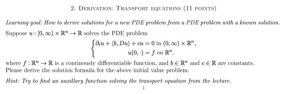

solve the modified transport equation using the method of characteristics.
##\partial_t u + <b, Du> + cu=0##
##u(0,x)=f##
Hi all, I
Fix $$(t,x) ∈ (0,\infty) \times R^n$$and consider auxillary function
$$w(s)=u(t+s,x+sb)$$
Then, $$\partial_s w(s)=(\partial_tu)(t+s,x+sb)\frac{d}{ds}(t+s)+<Du(t+s,x+sb)\frac{d}{ds}(x+sb)>$$
$$=(\partial_tu)(t+s,x+sb)+<b,Du(t+s,x+sb)>$$
$$=-cu(t+s,x+sb)$$
$$\partial_sw(s)=-cu(t+s,x+sb)$$
by Fundamental theorem of calculus,
$$u(t,x)-f(x-tb)=u(t,x)-u(0,x-tb)$$
$$=w(0)-w(-t)$$
$$=\int^0_{-t}\partial_sw(s)ds$$
$$=\int^0_{-t}-cu(t+s,x+sb)ds$$
$$s_o=s+t$$
$$=\int^t_{0}cu(s_o,x+(s_o-t)b)ds_o$$
$$u(t,x)=f(x-tb)+\int^t_{0}cu(s_o,x+(s_o-t)b)ds_o$$
You've gone astray somewhere; this one has a closed-form analytic solution in terms of [itex]f[/itex].
Start by setting [itex]u(t,x) = e^{\alpha t}v(t,x)[/itex] and choose [itex]\alpha[/itex] such that [itex]v[/itex] satisfies [tex] \partial_t v + (b, Dv) = 0[/tex] subject to [itex]v(0,\cdot) = f[/itex]. Hopefully this is the "transport equation" as defined in lectures.
That PDE in ##v## is the homogeneous transport equation we learned in lecture. I think our original problem is a transport equation with an inhomogeneous term. To be honest, I don't know whether that closed-form analytic solution is ultimately different from the answer from my professor's notes.
I looked in his notes and found this:
Given a PDE problem
##\partial_t u+<b,Du>=f## for ##u## in ##t\times R^n##
##u(0,x)=g## for ##g## on ##\left\{t=0\right\}\times R^n##
(The term in <> is the dot product of ##b## in ##R^n## and ##Du## the gradient of ##u##.)
The solution is given by ##u(t,x)=g(x-tb)+\int^t_0 f(s, x+(s-t)b)ds##
Our problem has ##-cu## as the inhomogeneous term, and I adapted the solution to fit the problem. I am not understanding the proof from his notes yet, that I copied almost directly into my solution. That is the method of characteristics, and it is not coming so easily yet.
The method of characteristics turns a PDE problem into an ODE problem (if the PDE is inhomogeneous) along lines parallel to ##(1, b)##. If the PDE is homogeneous, then the solutions become constant on lines parallel to ##(1, b)##. I can visualize this for the homogeneous case for ##u(t,x)## in ##R^2##, but not for higher dimensions.
I made a mistake with my first answer because it should have said ##u(t,x)=f(x-tb)-\int^t_{0}cu(s_o,x+(s_o-t)b)ds_o## instead of ##u(t,x)=f(x-tb)+\int^t_{0}cu(s_o,x+(s_o-t)b)ds_o##
edited for grammar
