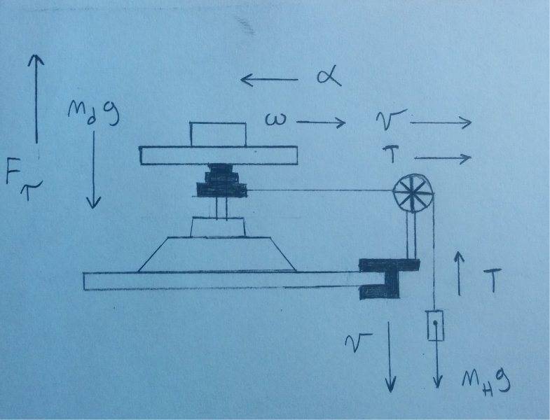

Hi all,
I just had a quick question regarding a problem that I have to write a lab report on. The problem involves solving for the moment of inertia of a system that involves a pulley with a hanging mass attached to a spool that turns a flywheel. The solution is supposed to be in terms of the mass the hanging weight and the acceleration of the weight. In lab we were eventually given the equation that could be used to solve for the moment of inertia. It is as follows: I={[r2(mg-ma)]/α} My question involves how to derive this. I know that it is a sum of all forces problem, but I can't seem to get the right answer. Here is a link to the problem. It is on the second page and is titled "Moment of Inertia Problem".
∑F=ma
∑τ=Iα
a=rα, α=a/r
mh = The mass of the hanging weight
Md = The mass of the disk, ring and spool configuration
r = the radius of the spool
Here is a drawing I made of the situation:
My attempt at the solution is as follows:
∑Fy = mha
mhg - τ = mha
τ = mhg - mha
∑τ = Iα ----------> I = τ/α
I = (mhg - mha)/α
α = a/r
I = [r(mhg - mha)/a]
I am unsure where to get the other r from.
Thanks for any help!

You are using the variable, τ, for two different things. (It looks like maybe tau, rather than letter, t .)
The τ in the force equations is tension. Usually we use uppercase T .
The one I highlight in red above, τ, is torque.
How is torque, τ, related to tension, T, in this case?

Actually, I did mean for τ to be torque in each equation. I realize now that I totally forgot to add tension into my ∑Fy equation. I will try that and see if I can get a better result. Thanks for the help!
I tried something else, and I think I am a little closer to a solution.
τ = Fdsinθ, τ = Iα, α = a/r, d = r = the radius of the spool, F = mhg - mha
Fr = Iα
Fr = I(a/r)
Fr2 = Ia
(Fr2/a) = I
I = [r2(mhg - mha)]/a
This solution is closer, but instead of 'α' in the denominator, there is just 'a'. Perhaps I wrote something down wrong in my lab notebook?

Yep, I did write something down wrong. It is supposed to be 'a' in the denominator. Thanks for the help Sammy, and sorry for the error!
