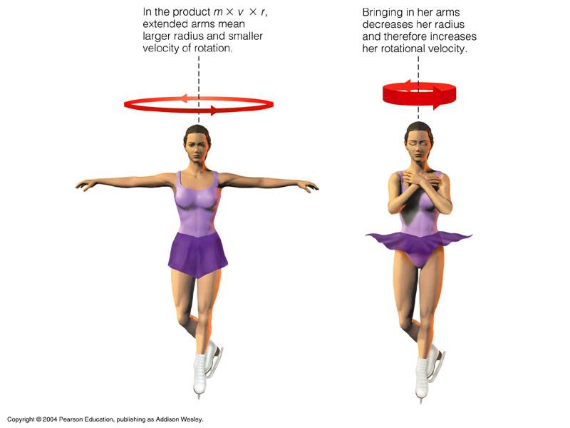

Okay, if we consider the arms as two uniform rods of length l and the body as a rod of radius r, when the arms are outstreched how far is the centre of mass of the arms away from the axis of rotation? Assuming the skater rotates about the centre of their body?
Now consider the centres of mass of the arms when they are by the skater's side.

The bodies centre of mass doesn't rotate because it is on the axis of rotation, i.e. the skater is rotating about her median line. What happens to the moment of inertia if the arms are brought close to the body?

Where are you getting this information from? I have read the website and there is no reference to this. My take is as in this picture;

Sorry to get in the middle of your excellent instruction, Hootenanny, but I thought I should get this out of the way : Wikipedia's explanation is wrong, wrong, wrong!
This formula explains the speeding up of ice skaters when they pull in their arms. Since the ice is nearly frictionless, the kinetic energy should stay constant during their spin. When they pull in their arms, the skaters decrease their moment of inertia I (their mass is more concentrated close to the rotation axis). To keep the kinetic energy constant, the angular velocity ω must increase; hence, the skaters spin faster.
WRONG! Rotational Kinetic Energy is NOT conserved. Angular momentum IS conserved, since negligible external torque acts on the skater. When the skater draws her arms in, she gains rotational kinetic energy (which comes from the conversion of biochemical potential energy to kinetic energy). When she let's her arms go out, she loses rotational KE (this is a more stable state, under normal circumstances she has to hold her arms in while spinning to prevent them from going out as far as possible from the axis of rotation).

Oh a misunderstanding from my side, i thought we were talking about ice skater, they who tries to do a distance as fast as possible. anyway I got worried for awhile, and I started to believe I had misunderstood something.

Take note of the blatent mistake Curious pointed out (and I missed :blushing: :mad: ) ROTATIONAL KINETIC ENERGY IS NOT CONSERVED, however, angular momentum is.
