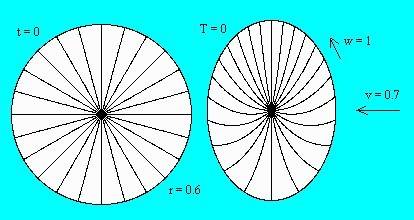

Fig.8. The non-rotating disk is drawn to the left and the rolling disk to the right. Radial lines of the rolling disk are curved as observed by simultaneity in the frame##K’##

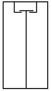

##\ \ \ \ \ ##They have considered a wheel or a disk. Now we consider the momentum of a spokes on the wheel.
##\ \ \ \ \ ##With parameter##r_A=100m##, ##ω=-2.7E6rad/s##,##v=-0.9c##, using numerical methods, get the shape of AB observed in ##K’##.

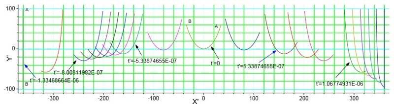

##\ \ \ \ \ ## In ##K’##, at time##t_1’##=0, an event occurs at the coordinate of point ## D( x_{D1}’, y_{D1}’ , 0 , t_1 ’ )##; another event occurs at the coordinate of point ## E( x_{E1}’, y_{E1}’ , 0 , t_1 ’ )##. Using Lorentz transformation between two inertial frames, get the two events occurs at ## ( x_{D t_{D\ one }}, y_{D t_{D\ one }}, 0 , t_ {D\ one } )##, and ## ( x_{E t_{E\ one }}, y_{E t_{E\ one }} , 0 , t_ {E\ one } )## in##K##. ## t_ {D\ one }≠ t_ {E\ one }##.
##\ \ \ \ \ ##When ##r_A=10m##, ##ω=2.4E7rad/s##, ##v=0.8c##, ##r_D=r_E=6m##. The approximate values by the numerical calculation are as follows:
##\ \ \ \ \ #### D( x_{D1}’, y_{D1}’ , 0 , t_1 ’ )##is (3.3699, 2.110599,0, 6.46E-16).
##\ \ \ \ \ #### E( x_{E1}’, y_{E1}’ , 0 , t_1 ’ )##is (-3.3699, 2.110599,0, -6.46E-16).
##\ \ \ \ \ #### ( x_{D t_{D\ one }}, y_{D t_{D\ one }}, 0 , t_ {D\ one } )##is (5.616526, 2.110599,0,1.497740E-08) .
##\ \ \ \ \ #### ( x_{E t_{E\ one }}, y_{E t_{E\ one }} , 0 , t_ {E\ one } )## is (-5.616526, 2.110599,0,-1.497740E-08).

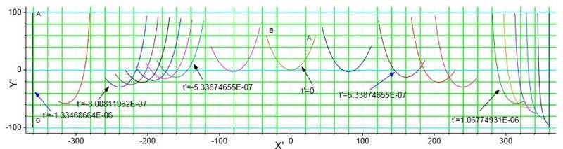

##\ \ \ \ \ ##Set ##ω##>0, ##v=ωr_A <c##.
##\ \ \ \ \ ##The shape of AB at the two giving moment is roughly like the lower figure, observed in##K’##.

I see no mention of you computing the stresses in the rod, though I see some talk about a "numerical computation", I don't know what formula you used to do said computations. I'd assume they're based on point masses and don't use tensor methods, however.
WIthout including the stresses in the rod, any answer will only be an approximation to the full relativistic answer Energy, momentum, and stress are all part of a larger relativistic object, the stress-energy tensor. Without including all the terms of the stress energy tensor (specifically the stres terms) in the calculation, I don't believe you'll get a totally self-consistent relativistic answer. If the rod is rotating slowly enough where the stresses are small, one might get an approximate answer, it's unclear exactly when/how the approximation breaks down without further analysis, however.
The particles composing the rod are not isolated, they are interacting via forces. Hence all the previous cautions about non-isolated systems apply.
I'm not sure exactly what the goal is, if the rod is rotating around the midpoint, the total momentum is obviously zero by symmetry. This leaves the computation of the energy of the rod rotating around it's midpoint, and the angular momentum of the rod as the interesting physical quantities.
My general reaction is that the fundamental approach needs revision, you won't get a meaningful answer with a point-particle based approach. You really need to learn about the stress-energy tensor to solve this sort of problem.
Egan has dome some work on the relativsitic rotating hoop that illustrate a valid approach to a similar problem, though it's not peer-reviewed. http://www.gregegan.net/SCIENCE/Rings/Rings.html

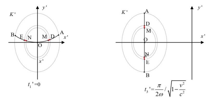

##\ \ \ \ \ ##The shape of a rotating rod in different inertial reference frames.
##\ \ \ \ \ ##In this section, only consider the shape of rods in different inertial reference frames. It does not involve the distribution of quality and tension.
##\ \ \ \ \ ##In ##K##, an isolated rod AB rotates around its mid point O at uniform angular velocity ##ω##, keeps the linear state.
##\ \ \ \ \ ##In ##K##, the shape of the rod is determined by its motion equation.
##\ \ \ \ \ ##By using Lorenz transform between ##K## and ##K’##, we get the shape of the rod in ##K’##.
##\ \ \ \ \ ##For example, if we want to get the shape of the rod at time ##t_1’## in ##K’##. For each point on AB, such as point D on OA, Solving equations

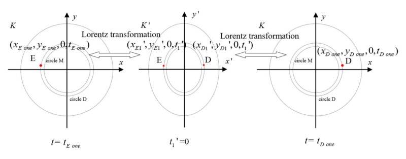

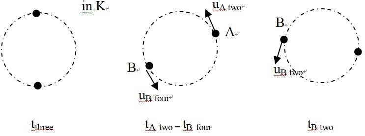

Consider two co-revolving particles (on opposite sides of a circle), each of rest mass ##m_0##, in ##K##.
Assume, the centre of the two particles is a fixed point in ##K##.
The total 4-momentum ##P(t)## is ##(2γ(rω)m_0,0,0,0)## in ##K##.
But the total 4-momentum of the two particles ## P(t')## in ##K'## isn’t always equal to a constant.
At time ##{t_3}'##, ##P({t_3}')## is ##(2γ(v)γ(rω)m_0,-2γ(v)γ(rω)m_0 v, 0,0)##.
At time ##{t_2}'##, ##P({t_2}')## is ##(2γ(v)γ(rω)m_0, γ(v)γ(rω)m_0 (u_{A \ two \ x}-v) +γ(v)γ(rω)m_0 (u_{B \ two \ x} -v), \ \ \ ,0)##. ##P({t_2}')## is not ##( 2γ(v)γ(rω)m_0, γ(v)γ(rω)m_0 (u_{A \ two \ x}-v) +γ(v)γ(rω)m_0 (u_{B \ four\ x} -v) ,\ \ \ ,0)##.
The 4-momentum of particle ##A ## in ##K'## at time ##{t_2}'## and The 4-momentum of particle ##B ## in ##K'## at time ##{t_4}'##, ##P(A,{t_2}')##+ ##P(B,{t_4}')##, is ##(2γ(v)γ(rω)m_0,γ(v)γ(rω)m_0 (u_{A \ two \ x}-v)+γ(v)γ(rω)m_0 (u_{B \ four\ x} -v) , \ \ \ ,0)##, which is equal to ##(2γ(v)γ(rω)m_0,-2γ(v)γ(rω)m_0 v, 0,0)##.
Because the two particles is not an isolated system, this is not contradictory to conservation of momentum.

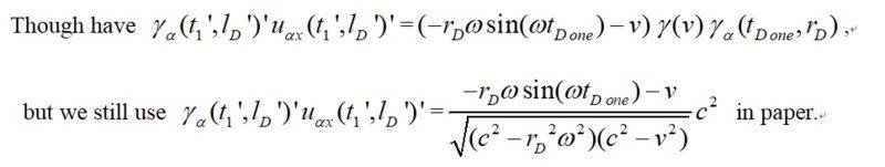

My calculation in part3 is to get ##{γ(t’,l’) }’ {u_{x}{(t’,l’) }}’ ##.
##γ_ {D} ({ t}’) ’ u_ {Dx} ({ t}’) ’##, which has a expression at post #15.
Through your message, I can write it as ##γ_ {D} ({ t}’) ’ u_ {Dx} ({ t}’) ’##=## { (u_ {Dx} ( t) –v) γ(v)γ(r_ {D}ω)}##=## {(-r_D ω \sin(ωt_{D\ one }) –v) γ(v)γ(r_ {D}ω)}##.
Through your post #18, it is correct.

In fact, all my statements in post #15 are for two purposes.
One is: the relationship of ##{t_1}’## and ##t_{D\ one }, t_{E\ one } ##; the relationship of ##{t_3}’## and ##t_3##, for Relativity of simultaneity.
Another one is: when ##{t_1}’=0##, the ##y## coordinates of rod ##AB## except point ## O## are greater than 0; when ##{t_3}’ ##, the ##x## coordinates of rod ##AB## are equal to each.

I found I have done a wrong decision.
This is the reason that my knowledge is too narrow.
Now I will use ##γ_ {D} ({ t}’) ’ u_ {Dx} ({ t}’) ’##=## { (u_ {Dx} ( t) –v) γ(v)γ(r_ {D}ω)}##=## {(-r_D ω \sin(ωt_{D\ one }) –v) γ(v)γ(r_ {D}ω)}## again.

@PAllen, Two identical objects ## A## and ##B## rest in ##K##, before time ##t_0##:
They have the same sum rest masses.
One of them (##B##) is deformed under external force, from time ##t_0## to ##t_9##:
After time ##t_9##, they don’t have the same sum rest masses.
In fact, we consider the internal tension or internal potential energy as rest mass.
When we calculate the change of momentum of objects ##B## in ##K’##, we have two ways.
One is: Calculate the external force act on objects ##B## in ##K’##, and integrate it. When calculate the external force act on objects ##B## in ##K’## , we need to use tension.
The other one is: Calculate the momentum of objects ##B## in ##K’## at time(##t_{0}’##) before its deformation and at time (##t_{9}’##) after its deformation. Then compare these two values. If we can get the rest mass of objects ##B##, we don’t need to calculate the tension and the external force.
So, for the rotating bar, we do not need to know the specific value of its internal tension, nor do we need to know what laws its tension and deformation obey, as long as we know that it is a born rigid body. A born rigid body with internal tension.
So, for the rotating bar, we have know its rest mass line density along the rod. We do not need to know the specific value of its internal tension, nor do we need to know what laws its tension and deformation obey, as long as we know that it is a born rigid body. A born rigid body with internal tension.
