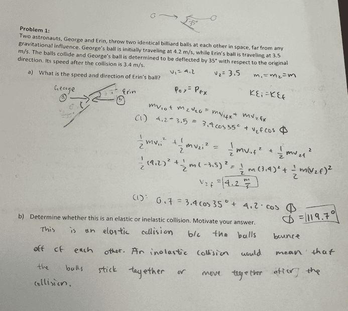

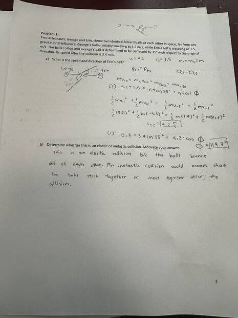

Two astronauts, George and Erin, throw two identical billiard balls at each other in space, far from any gravitational influence. George’s ball is initially traveling at 4.2 m/s, while Erin’s ball is traveling at 3.5 m/s. The balls collide and George’s ball is determined to be deflected by 35° with respect to the original direction. Its speed after the collision is 3.4 m/s.
a) What is the speed and direction of Erin’s ball?
b) Determine whether this is an elastic or inelastic collision. Motivate your answer.
pi=pf
m1v1+m2v2=m1v1+m2v2 (Final)
and KEi=KEf
My attempt is shown below.
Here is a better photo:
Welcome to PF!
The collision can be inelastic even if the balls don't stick together. Inelastic simply means that total KE is not conserved.
If the balls stick together, the collision is often called "completely inelastic".
Please type in your work using LaTeX if possible rather than posting pictures of your handwritten work. Regulations and suggestions concerning the posting of homework questions can be found here.

here is my work though:
pi=pf
mv1(initial) + mv2(initial) = mv1 (final) + mv2 (final)
so substitute the values im given:
4.2-3.5=3.5cos35 + v2cosx (i think it's subtraction since Erin's ball in this case is being thrown in the opposite direction)
In an elastic collision the KE is conserved so KEi=KEf
1/2mv1^2 (initial) + 1/2mv2^2 (initial) = 1/2mv1^2 (final) + 1/2mv2^2 (final)
plugging all the information in I find that v2 is 4.2 m/s.
i substitute the value i found for v2 into the first equation and i get that 0.7=3.4cos35 + 4.2cosx
so therefore I use the inverse cosine function and i calculate x to be an angle of 119.7 degrees.
i'm not sure if this is right or not because i was trying to imagine the scenario in my head but 119 degrees doesn't seem right.

You are assuming the collision is elastic. This is not justified.
For help with LaTeX, see this guide. Also, there are some formatting tools available on the toolbar at the top of the input window that you can use to help format mathematical expressions.
In addition to what has already been said about energy conservation, your momentum conservation is incomplete. This is a two-dimensional collision which means that you need to write two momentum conservation equations, one in the direction of the original motion and one perpendicular to it.
