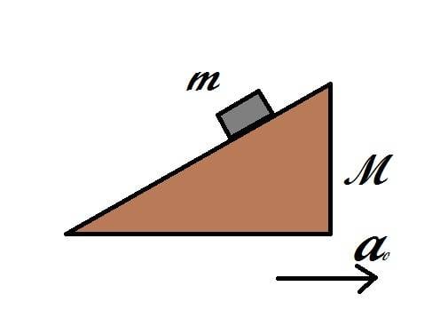

I don't understand the motion of an accelerating wedge and a block. I'd really appreciate if you make me understand the motion in both an inertial and a non inertial reference frame.
Here's a figure I have made, a0 is the acceleration on the wedge with respect to an inertial frame, towards right.
Is ##a_0## given? If so then the mass M of the wedge is not needed

Yes , a0 is towards right. I apologise, I made a mistake earlier by saying a0 is towards left.
Let's start from inertial viewpoint. Write down the Newton Second Law for the briсk

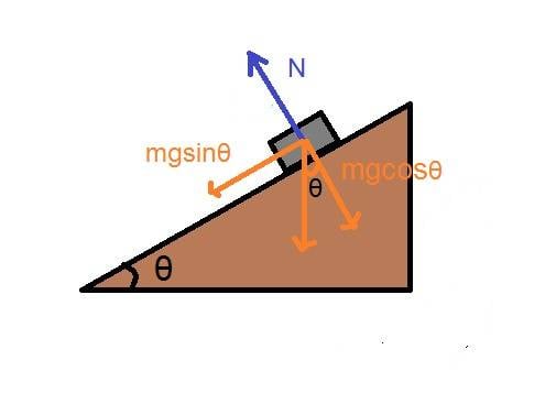

Let's take the angle of incline as θ. Applying Newton's Second Law to the block;
∑Fx = mgsinθ = ma (Where a is acceleration with respect to ground, which we take to be inertial.)
∑Fy = N - mgcosθ = 0 ⇔ N = mgcosθ
Am I correct?

Partly. You seem to be adopting a coordinate system where "x" is along an axis rotated θ up from the horizontal and where "y" is along the axis at right angles to that. [This coordinate system is notionally fixed in space. It does not move with the wedge]. Against that coordinate system, only g has any component along the x axis. We may immediately determine the x component of the acceleration of the block. You have done that and correctly computed ##ma_x## for the block.
You have not computed ##m\vec{a}## for the block.
You have not justified the claim that N = mg cos θ. Why should that be so?

Doesn't the block stay in contact with wedge through out the motion? Let's see, the wedge moves to right with acceleration a0, and at the same time, the block moves down with an acceleration of mgcosθ. I thought the normal force stayed same. I must admit, this motion is confusing me.
The normal force does not stay the same. The block does not move down with an acceleration mg cosθ (as it would if the normal force were zero).
Is ##a_0## given? Or is is something that you wish to compute?
Ah, yes, that makes sense. I am new to Newtonian mechanics, so I am likely to make mistakes. Can you tell me why normal force does not remain the same?

The wedge is accelerating (or is allowed to accelerate -- you still have not said which). If ##\vec{A}## is the acceleration of the wedge, what is Ay? If Ay is the acceleration of the wedge in the y direction, what is ay -- the acceleration of the block in the y direction?
Write down a force balance for the block in the y direction. ∑Fy = may

The wedge is accelerating towards right. Ay should be 0, as the wedge is not acceleration upward or downward. What do you mean by "Ay is the acceleration of the block"? Didn't you just say A is the acceleration on the wedge?
You rotated your coordinate axes. "right" has a component in the direction of negative y.

You were trying to figure out the normal force. For normal force, what matters is the acceleration of the block in the direction perpendicular to the surface.
You persist in not clarifying whether the acceleration of the wedge is a given fixed constant or whether it is something to be computed. I will assume that it is a given fixed constant, A0. In that case, the acceleration of the block and of the wedge in the y direction is -A0sin θ.
Edit: fixed the sign. This is a "downward" acceleration.
With that information in hand, can you now expand ∑Fy = may with all relevant forces?

So, there is also an acceleration in the y direction for the block? I did not know that, I thought the block was only accelerating in x direction. Why is the block accelerating in the y direction?
Because it is in contact with the wedge and the wedge is accelerating in the y direction.

Yes sure, I made the assumption that the block is always gliding along the block. If it gets detached from the block, it's way more complicated of course!
  • #34
vanhees71 said:
I thought the wedge is forced to move with constant acceleration in ##x## direction. For me to analyze it using forces is pretty cumbersome, but with the Lagrange method it's pretty simple.
You can also argue easily with the equivalence principle and calculate the effective "gravitational field" in the rest frame of the wedge and then project the force on the block. You'll get something like ##F_{\parallel}=-m (g\sin \alpha + a_0 \cos \alpha)## where ##\alpha## is the direction of the wedge wrt. the ##x## axis.
Isn't ma0cosα a fictitious force? As you're introducing a fictitious force , doesn't that mean the result you'll get from the accelerating frame of wedge will be different than the actual result calculated from an inertial frame?
  • #35
NoahCygnus said:
Isn't ##ma_0 \cos \alpha## a fictitious force? As you're introducing a fictitious force , doesn't that mean the result you'll get from the accelerating frame of wedge will be different than the actual result calculated from an inertial frame?
Sure, it's a fictitious force. But Newton's second law still applies. The real physical forces that you can calculate using the accelerating frame are the same as the real physical forces that you would calculate using an inertial frame.
The accelerations that you calculate in the accelerating frame would indeed need to be adjusted (aka "transformed") before they are correct for the ground frame. But adopting the accelerating frame may simplify the analysis enough that it's worth the added effort of a transformation step at the end.
Likes NoahCygnus
  • #36
Yes so in the end I'll need to make adjustments to the result obtained from an accelerating frame. I will have to subtract ma0cosα in the end from the result , right ?
  • #38
What result did you start with in the accelerating frame? What end result did you wish to obtain?
