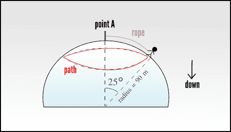

"You are on a dome, which is a hemisphere, with a 90 m radius. You hold a rope to point A at the peak of the dome. The rope remains in contact with the outer surface of the dome and is long enough to make an angle of 25° as shown. You are given an initial horizontal velocity tangent to the dome and you move in a horizontal circle, keeping the rope tight. You have a maximum speed above which you cannot maintain contact with the frictionless dome surface.
What's the time that it takes you to complete one circuit around the dome at this speed?"
Force equations, centripetal acceleration equations
Okay so I'm thinking this is a centripetal acceleration question. Since the motion is in a horizontal circle I'm thinking I'll need the radius of the circle. I think the angle and dome radius form a right angle triangle so I can get the opposite side of the angle which would be the radius right? So now I have the radius.

edit: I think I got it. There has to be a vertical (or would it be horizontal) force of gravity acting on this guy as he's moving around this dome, correct? (I assume no normal force since there is no friction and Ff = uk * Fn) However, Fg must be equal to the centripetal force applied as he's moving across the dome to balance, correct? In other words:
Fnet = Fc = Fg
m*a = m*g
a = g
v^2 / r = mgcostheta
v = sqrt(mgcostheta/r)
that's how i would get v
to get d, i would get the circumference of the circle, but I'm not sure if it's 2*pi*r where r is the 90 m or if it's the opposite side of the angle?
with v and d, i would have v = d/t and rearrange for t = d/v.so where did i go wrong?

there are two forces not one, the weight vertically down, and the tension along the tangent
start again :smile:

true, there should be tension... but how would I calculate tension? am i looking for the verticle component, as in Ty? if so, how do I get that angle?
i don't really understand how one incorporates tension?
nobody's asked you for the tension, so ignore it
take components (of force and acceleration) perpendicular to it :smile:

so would it be like this:
If so, how would I get the forces perpendicular to the tension?
the components of forces? :wink:
there's only one candidate, and that's gravity …
just use cos as usual :smile:

Will splitting the force of gravity into it's x-component, then using that as the centripetal acceleration to solve for speed using the following formula work?

So Fnet = Fg where Fg = mgcos25?
Or Fnet = Fc = mv^2/r = mgcos25?

no, because F = ma horizontally (i assume that's what you mean by "x") must also include a component of the tension :wink:

So incorporating tension: Ty= -Fg
then solve for Tx and use that acceleration as the centripetal acceleration?

yes … "perpendicular to the tension", not horizontal
yes, that would do it …
but why bother with two equations when the one equation perpendicular to the string will solve it, without finding T? :wink:

So it's Fgy, right? If you're looking at the diagram as a rotated coordinate system, Tension would be in the horizontal and Fg would have x- and y- components, correct?

Tiny-Tim, can the equation Fc= Fgy be used to solve the problem?
so it becomes mv^2/r=mgcos25
the masses cancel each other out.
and you get the v
then you can use v=2piR/T
