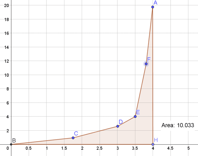

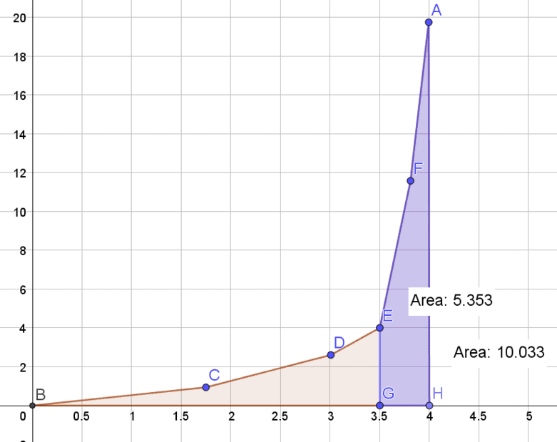

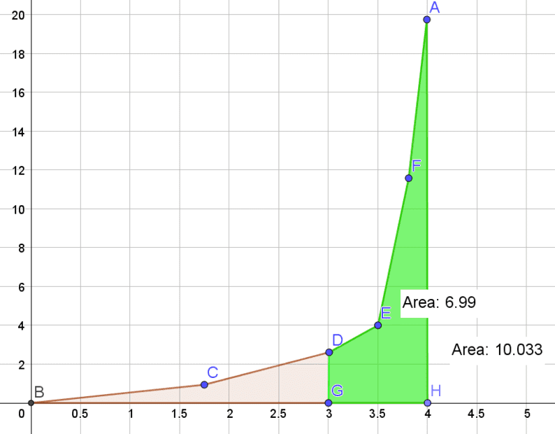

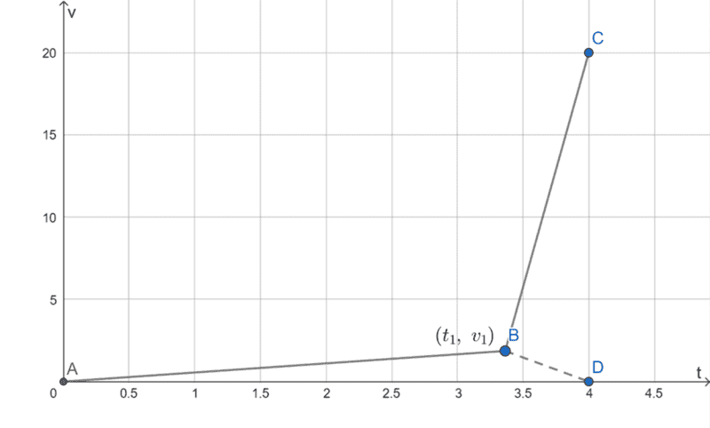

Honestly guys I think I've hit a brick wall. I struggle to make sense of the equations above since they are too abstract, it's been too long since I did any proper maths! I have however tried to find a solution based on my understanding (or lack thereof!) of the above recommendations. Here is what I did:
  1. Plot a velocity time graph where u = 0, v = 20, t = 4. The shape of this graph is something I arbitrarily set to an exponential shape, given that this is the profile I am looking for. I think you guys were recommending this above too.
  2. Use step wise integrals to find the area under the graph, in order to create a corresponding displacement time graph. Remember that I said I need displacement as a function of time. (I have a function that can do this accurately for as many intervals as needed).
  3. Now Step 2 doesn't take into account my distance of s = 10m since it only looks at the velocity time graph, so the y-axis of my displacement time graph is not correctly scaled. Therefore I scale it to match my displacement profile of s = 10.
  4. I move the particle using this displacement time graph.
The result of this process is below:
The motion discussed in this thread is the motion from off-screen right up until it hits the circle directly below the yellow point. After that the particle follows a circular motion with an angular velocity matched to the linear velocity. So if it works, we should see a nice smooth transition.
You can see however that it has not worked. I get an acceleration but it is too rapid, which makes the particle suddenly slow down after the linear motion has occurred. I assume that I have made a mistake in Steps 2-3 because I am effectively experimenting here without actually knowing what I am doing. :headbang:
If anyone could please outline where I've gone wrong, I'd really appreciate it.

Very hard to tell if you do not show any equations.

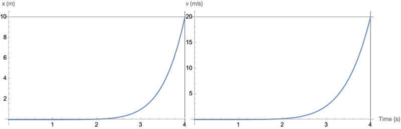

So your ultimate goal is for that square to start at a distance 10 m from the lowest point of a circle, accelerate towards it in 4 seconds, hit speed 20 m/s and then it will move along that circle with such tangential speed?
Then yes, an exponential acceleration will make the last second cover 87% of the total distance (3,46 m) and not look any nice.

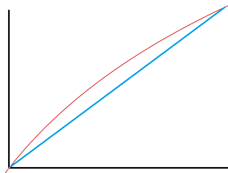

Thing is, if the velocity is linear in time, then acceleration is constant, and then SUVAT equations gave you negative acceleration so that the particle initially moved in the wrong direction. Thus linear velocity is not possible.
Yes precisely, I recall that's why it's necessary to use a varying acceleration. I think I'm getting closer but still some ways away from a working solution.

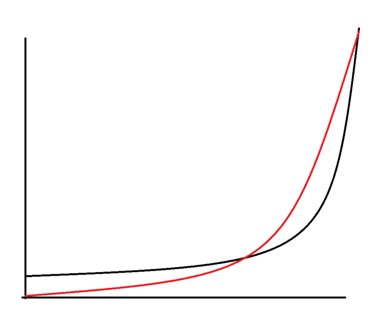

That's better, cubic easing is always going to transition better to the next stage than exponential.
  • #45
I have animations for exponential and power-function too :)
If I knew the whole story, that the particle was going to move in a circle with constant angular speed, I would have suggested something else. Exponentials are easy to differentiate and integrate.

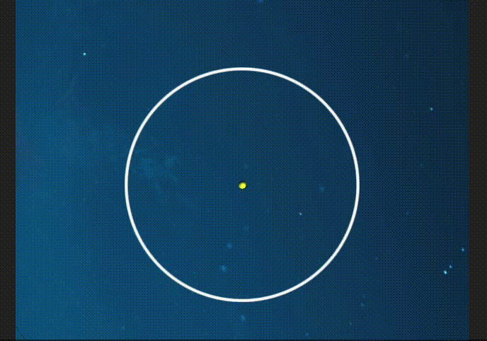

I cannot thank you enough for taking the time to write all that out, seriously thanks! I have implemented your equation and it is a big improvement! I don't actually see an initial acceleration in the wrong direction as position is always positive when I feed in the V,S,T,t values.
Here is what it produces:
It's probably hard to see given the jerky GIF, but it is more clear in the 60 FPS that I am seeing. The square does still appear to arrive the destination a little too fast, causing an apparent slowdown as it starts orbiting. Is this due to the cubic function? As I mentioned it's a lot better but still not smooth per se.

@Jack7
Do you have correct radius and tangential speed for the circular motion?

Yes I do, and I know for a fact that it is correct because if I send the square in with a simple linear velocity (no acceleration), the transition is perfectly smooth. So I can be certain that my angular and linear velocities are matched.

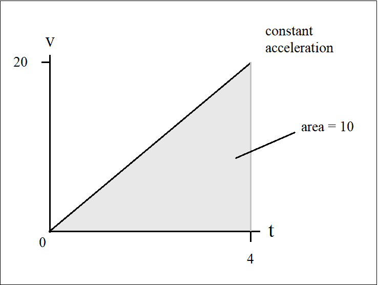

Could I please clarify something with you guys before I continue trying to implement your recommendations? Because I still feel that my understanding is lacking, and that I need to get this point clear in my head before proceeding.
If I say: I want the particle to accelerate at a constant rate, in accordance with the specified s,v,t, I am essentially saying that the motion must follow this graph:
Question: Am I correct in saying this?
If so, the next question becomes whether this graph can actually be constructed. I believe the answer is no, hence we are trying to change the shape of the curve, such that the area underneath it does actually equal 10.
Is my understanding correct? Having it visualised in a graph helps tremendously since the equations are hard to derive any meaning from.

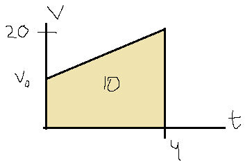

now the only way to get that area to become 10 is if v0 is negative, because the picture you posted shows the minimal area with v0≥0
You can come up with any kind of v(t) for your problem as long as the graph is above the horisontal axis between 0 < t < 4, it has v(4) = 20, and the area is equal to 10.

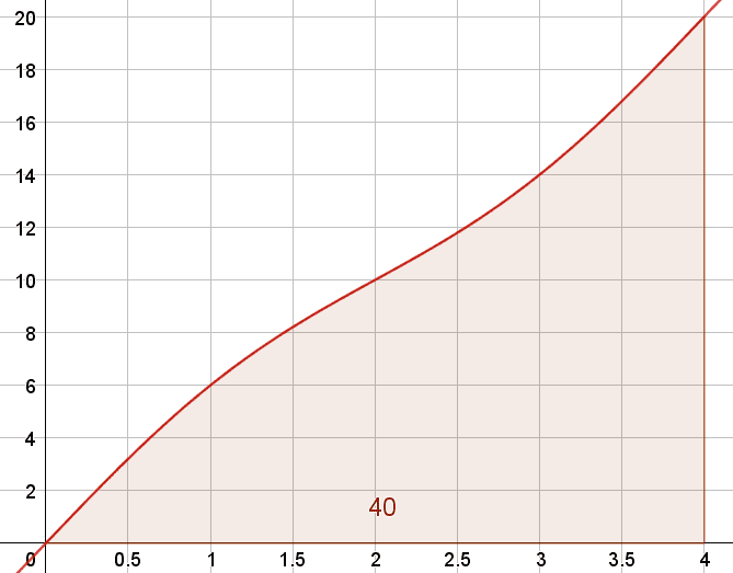

@malawi_glenn Thank you for clarifying that. What you are saying makes sense to me. My area is 40 so clearly the curve is invalid. It would reach 10m far too soon, which is what I was seeing in my first GIF. This makes sense.
Am I correct in thinking that there is only one curve (where v is always positive) that satisfies my needs? Our exercises up to now have been an attempt to find this curve. Is this correct?
  • #56
Jack7 said:
My area is 80
In that graph? How do you calculate the area of a triangle?
No there are "infinetly" many such curves. The excerises has been to attempt to find a curve that fulfils the constraints and is simple to calculate (e.g. you can determine the shape with a few parameters which can be calculated algebraically)
  • #57
Yeah, for a constant acceleration that you have shown ##v= at##, is the equation of the line. The area under the curve from ## t = 0 \rm{s} \to 4 \rm{s} ## ( which represents the distance traveled in time ## t = 0 \rm{s} \to 4 \rm{s} ## ) is already fixed at some value other than the value you are trying to make it be.
  • #58
malawi_glenn said:
In that graph? How do you calculate the area of a triangle?No there are "infinetly" many such curves. The excerises has been to attempt to find a curve that fulfils the constraints and is simple to calculate (e.g. you can determine the shape with a few parameters which can be calculated algebraically)
Apologies that was a typo, I meant to say the area is 40 (20 * 4 * 0.5 = 40).
