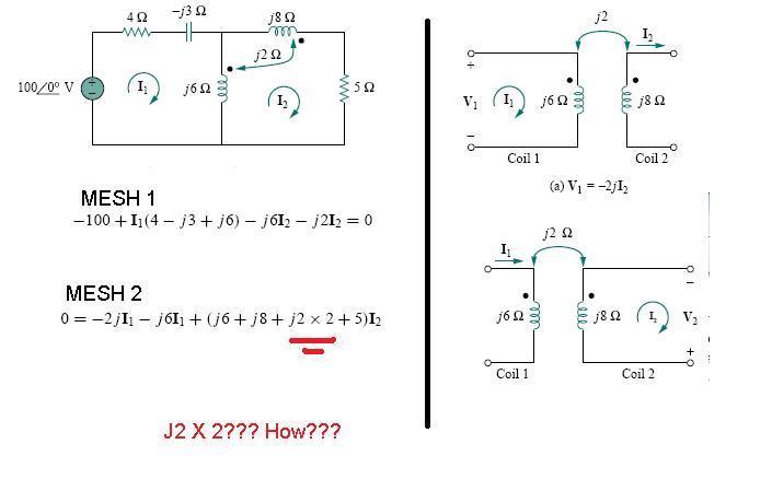

1.I don't understand where the J2X2 comes from. Everything else seems fine but why is there a J2x2 CHECK ATTACHED PICTURE
THANK YOU

well basically I am trying to do mesh analysis to calculate the mesh currents in that picture...
umm...those are the two equations that the book shows. I understand where all the terms in the first mesh equation come from, but I am confused about where j2x2 comes from in the 2nd mesh equationAnyone
know?
What you have is j2 occurring twice.
The first one is caused by current I2 in inductor j6; that causes a voltage of I2*j2 to be induced in the j8 inductor.
Then, the I2 current in inductor j8 also causes a voltage of I2*j2 to be induced in inductor j6.
When you have two coupled inductors in series in a loop, such as the I2 loop, the current in each inductor causes a voltage drop in that same inductor, but it also causes a voltage drop in the other inductor.
Thanks makes sense :)
