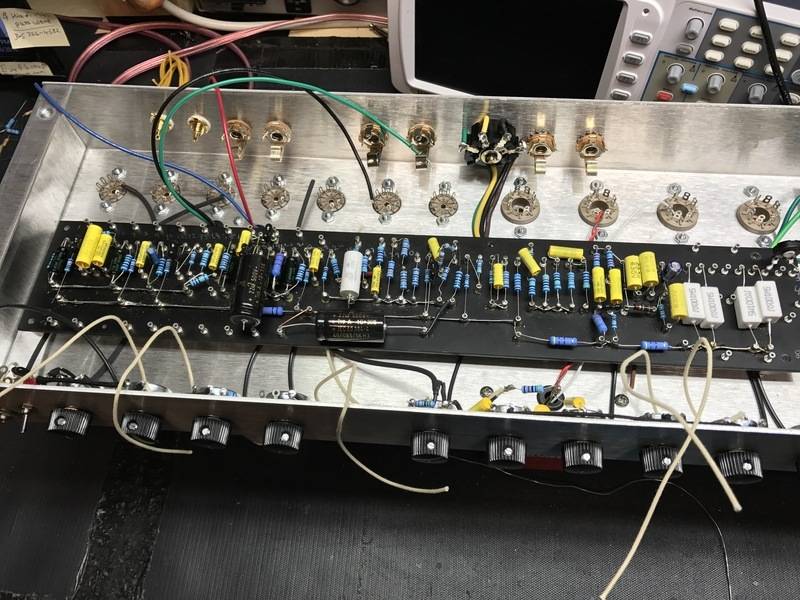

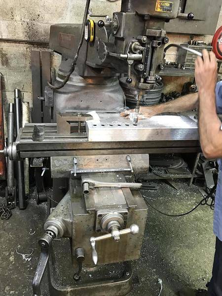

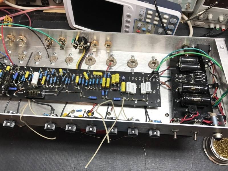

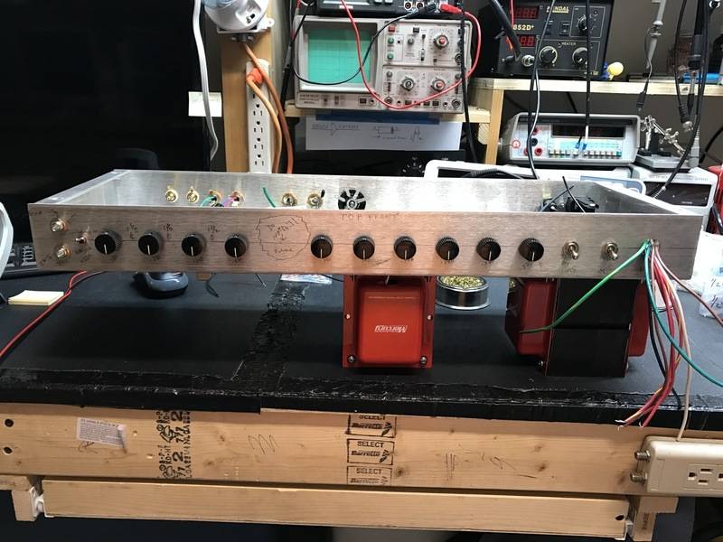

It takes real machines to build big amps!..lol
11 tubes, 2 channels, tube reverb, 100 watts, channel switching, DC tube heaters...somewhere in all this I must have lost my mind!...lol
I guess tomorrow I will see if this beast will work. It is by far the most complex amp I have dreamed up. My friend Dave drove down from Michigan to help me crank it up. I think we are about eight hours from lift off.
Cheers,
Billy

sweet !
do you do your own metal bending for the case as well ?
I wish I did but no sheet metal brake. I am also finding that all the different skills needed to build a completed amp is a bit much for me. Some days I wish I had all the tools in the world and other days I am glad I don't.
I am still struggling with basic electronics and need to stay focused on that, at least for a while. I have sort of jumped into the deep end of the pool. A 100 watt amp of this nature would be a complex project for anyone with years of experience. At my level, who knows... I know what I want it to do and sound like and I am sure I will get there but it is a bit stressful. Lots of kind people have helped me learn some stuff but nothing replaces years of experience. I have at least made a bit of progress in the few short months since I started all this.
Some of this is fun and some of this is just plain hard work!

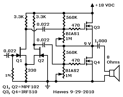

What a pity, I have no time to try this: a small tube amplifier with its transformer's output amplified by a precise current follower made of two powerful complementary MOSFETs! Such a follower (at least, if improved by an op-amp keeping the source voltage, the transformer's output, at zero) would add absolutely no distortion; therefore, all the distortion would remain "tube-like"; and the transformer could be small ― but with very thick-wired output coil feeding the MOSFETs' sources. The output transistors must of course be included in the feedback loop.

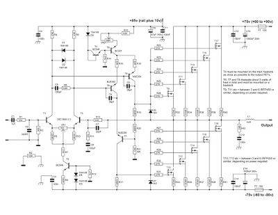

So why use tubes at all? MOSFETs have the same characteristics as a pentode...
Of course, transistors are much more precise than MOSFETS in the input stage. I would not use an op-amp since it is usually not good at handling large signals. But - here is a schematic for a 600W amplifier (http://www.elcircuit.com/2012/04/600-watt-mosfet-power-amplifier-with.html):
― but the thing is, it's awfully interesting to make the Class-B output stage to work as a current-follower, rather than classic voltage follower (and to do that, one have to use a current transformer before the output stage) ― because in that case the nasty crossover distortion could be completely eliminated ― because the sum of the drain currents is always practically equal to the input sum of the source currents ― very much unlike the input and output voltages of a classic power voltage-follower.
I am awfully sorry, have no schematic diagram to show at the moment, it's still in my head.
A current-follower is not hard to design, but I doubt it will be of any use. Just as a perfect voltage follower has zero output impedance, a perfect current follower has infinite output impedance. Since a loudspeaker does not have a constant impedance (see figure), driving it with a current will accentuate the nonlinearity instead of damping it.

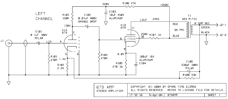

So what? The output pentode, in a classic simple tube amplifer, also has practically infinite output impedance; but the feedback (R108, C105 on the picture) from the speaker to the cathode of the before-output triode makes the output impedance of the whole amplifier low enough.
A similar feedback ought to be used in an amplifier with current-following MOSFETs at the output.
No. The purpose of the output transformer is to transform the output impedance of the power tube to an impedance low enough to handle the loudspeaker (if the turns ratio is n:1 , the impedance is transformed as n2:1). The purpose of the feedback circuit is to correct for the non-linearity in the output transformer.
One of the problems with the amplifier you show is that the "zero" current in the power tube goes through the output transformer all the time. This current creates a basic magnetic field in the output transformer, moving the operating point away from zero. Therefore push-pull stages ere preferred, since the "zero" current is supplied to both output tubes, but the currents act in opposite directions. For a discussion of output transformers, see http://www.turneraudio.com.au/output-trans-theory.htm.

That's the best discussion of output transformers I ever read! But look attentively: it says nothing about tube's own output impedance. It tells about the load impedance "seen by the tube" or which "suits the tube". It's all about getting power from that tube. A good pentode can give audio-voltage about 100V or so on its anode, and current about 0.03A or so; therefore, the speaker impedance has to be transformed to 3000 Ohm, to get full power. But that does not mean that the tube's own impedance is 3000 Ohm!
The output current and voltage of the best voltage follower are limited in the same way; yet the output impedance of that follower is very small and has nothing to do with those limits.

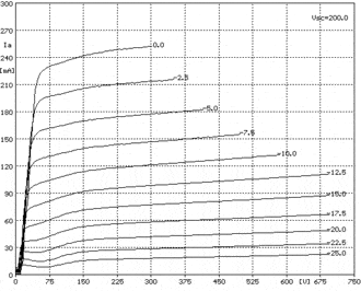

These are the characteristics of a pentode from Wikipedia: although it seems an awful big pentode (e.g. the big "horizontal" one from a huge ancient TV), its output impedance (at moderate currents) is hardly less than 30 000 Ohm (and I would have made it much greater with a cathode resistor):

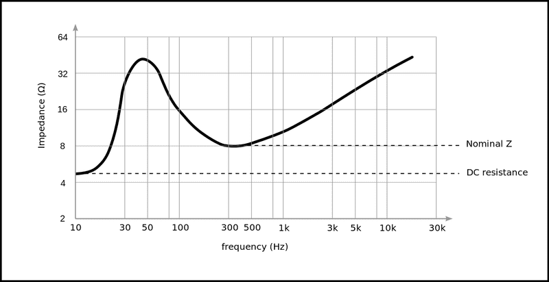

Today, practically all available audio amplifier and loudspeaker equipment works on the voltage drive principle without significant exceptions. This means that the power amplifier acts as a voltage source exhibiting low output impedance and thus strives to force the voltage across the load terminals to follow the applied signal without any regard to what the current through the load will be.
However, both technical aspects and listening experiences equally indicate that voltage drive is a poor choice if sound quality is to be given any worth. The fundamental reason is that the vague electromotive forces (EMF) that are generated by both the motion of the voice coil and its inductance seriously impair the critical voltage-to-current conversion, which in the voltage drive principle is left as the job of the loudspeaker.
The driving force (F), that sets the diaphragm in motion, is proportional to the current (I) flowing through the voice coil according to the well known formula F = BlI where the product Bl is called force factor (B = magnetic flux density; l = wire length in the magnetic field). B is the flux density that exists when the current is zero. (The current always induces its own magnetic field, which may react with adjacent iron, but the effect is not related to this equation.)
This force, then, determines the acceleration (A) of the diaphragm, which in the main operation area (the mass-controlled region) is got from the Newtonian law F = mA. The radiated pressure, in turn, follows the instantaneous acceleration and not the instantaneous displacement, as many mistakenly imagine.
The most remarkable thing here regarding loudspeakers is that the voltage between the ends of the wire does not appear anywhere in these equations. That is, the speaker driver in the end obeys only current, not caring what the voltage across the terminals happens to be.
