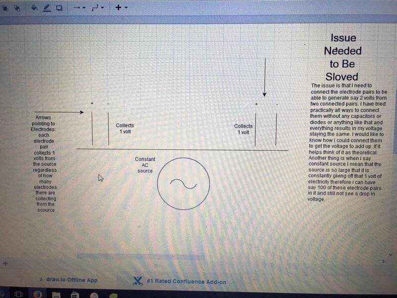

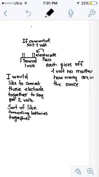

So I have a source that produces 1 volt of electricity. I have several electrode pairs put into this source. My multimeter shows that each of these pairs has one volt but I would like to interconnect this pair to say get two volts with two pairs interconnected. I could draw it out for u if it helps. Thanks
Thing is when I connect these electrodes I still only get one volt

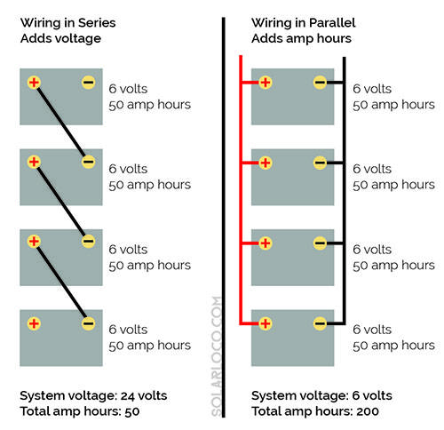

Is this what you're looking for (series and parallel circuits):
Thank you I will try this tonight and let you know how it worked out
I tried wiring in Series but it did not work

Hasan Khalil said:
pretty diagram, but it still doesn't answer my question
one more time ...
WHAT is your voltage source ?
Be VERY specific ...
is it a device ... what / make and model
No matter what your source is:
  • if you have a single source;
  • if you have a constant 1 volt between each pair of electrodes, no matter how many pairs you have;
Then it is because the pairs of electrodes are all connected in parallel with the source.
The only way to convert 1 volt into 2 volts is to use a transformer between your source and your electrodes.

It's a shame that the OP is not a bit more forthcoming about this. It strikes me that he's got a set of voltaic cells that are sharing the same bath of electrolyte.
Car batteries have 2V cells and 6 totally separate containers of acids. He may have a solution if he uses more containers for his liquid - whatever it is.
If that is indeed what the OP wants to do, then I misunderstood. Effectively the electrodes connected in "series" are shorting out, and only the first and last electrode would provide a path (through the electrolyte).

The screenshot mentions an AC source. That would seem to exclude all batteries.
That confused me too. I sort of ignored it, in the absence of any serious description of the equipment.
