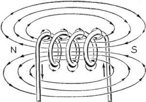

Hi,
I saw this video and I can't explain why the magnet is propelled to the end of the coil with such a huge force. Can someone explain it in clear terms. I also tried to use Flemings left hand (or right hand) rule but it did not give me a satisfactory answer.
Thanks,
SM
Magnets are typically coated in conductive metal, like nickel, for extended durability. Even if themselves not conductive, their metallic coating will conduct electricity from the battery to the copper coil. The current will flow between + and - through the coil, creating a magnetic field in the process:
The induced magnetic field will interact with the permanent magnets, propelling the battery assembly forward.
Thanks. That makes a lot of sense and also explains why an initial nudge is required to start the mechanism that propels the magnet all the way to the other end.
