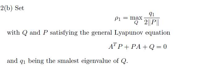

Where it says maxQ I don't understand.
Q is a matrix, so are A and P.
I know what q1 and the 2-norm of P are, but what on Earth does max Q mean?
I started with the matrix A, I've selected Q as positive definite arbitrarily, and I received a matrix P. I need to now find rho but I'm stuck on what max Q means.
maxQ means to take the maximum over all possible Q that satisfy the given equation. q1 and P will vary depending on what the matrix Q is.

There is no such thing. Matrices are not "ordered" and so do not have "max" or "min".
It's not "max Q", it is [tex]\begin{array} amax \\ Q\end{array}[/tex], the maximum taken by a numerical expression over all possible values of Q. This isn't saying anything about a maximum of Q, it's talking about the maximum value of the numerical expression [itex]q_1/||P||[/itex] where Q can be any matrix and P must be such that [itex]A^TP+ PA+ Q= 0[/itex]

Ok thanks, so I don't need to alter the calculation of [itex]q_1/(2||P||)[/itex] and treat it the same as if [tex]\begin{array} amax \\ Q\end{array}[/tex] wasn't there?
