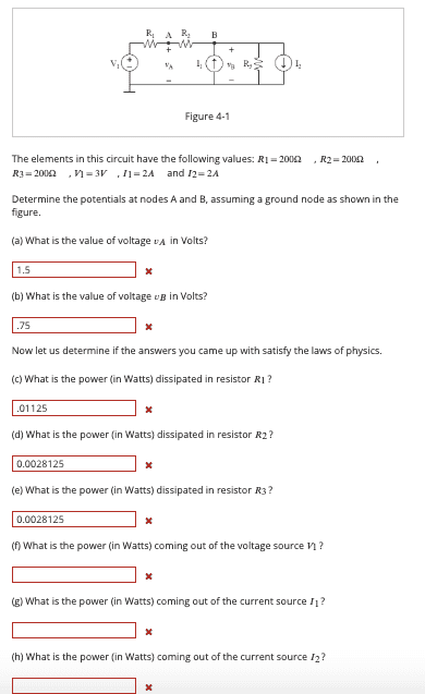

I attempted to solve this problem using the node method, however, I was unable to come up with the correct answers. Any help/guidance would be appreciated, thank you!
Kirchhoff's Current and Voltage Laws
Node Method
Attached is my work for the voltages, and the problem itself.

I1 and I2 are in parallel connection, equal magnitude and opposite direction, and therefore cancels out.
Your image of the problem is too small for forum members utilizing tablets or phones to decipher. Please post a larger image or ideally, type out the relevant information and provide a readable diagram of the circuit.
