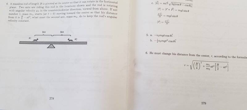

I've spent at least 1.5 hours on this problem trying to figure out what i did wrong and I can't find anything. With an exam in two days plus another chapter to go through.
Regardless, here are the problem(6) and answer, as well as my work. Hope you can read it, and the writing on the bottom left in red was just a variation of me using a negative value for m1(B/4) , as oppose to a positive like the right.
