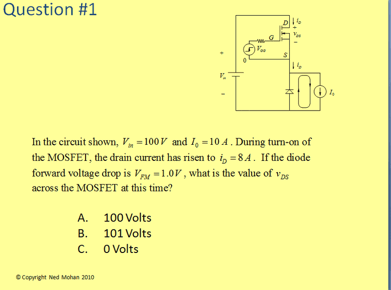

Hello all. It's been awhile since I took a circuits class, so any help would be greatly appreciated. Thanks in advance.
See attachment for circuit drawing and question.
OHM's law? V=IR
Idiode = Io - id
I've tried to approach this problem, but having a hard time starting it.

Try to eliminate the bad choices.
It's 100V, the diode is not conducting, so all the Mosfet drain current goes to the load.
