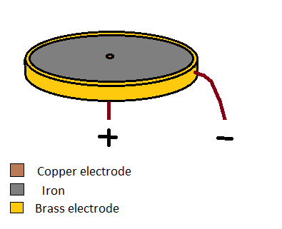

A DC current is flowing between two electrodes through a iron disk medium. Positive is attached to the copper shaft of the disc and the negative is attached to the outer brass periphery of the disk. The radius of the disk is 2,54mm (1 inch) and the height of the disk is 1cm. How does the magnetic field look/behave when a DC current is applied to the disk?
Right hand rule
I have searched online for the answer and made a few attempts at figuring it out myself but without any success. I can´t wrap my head around it.

Can you show us a sketch of the current distribution in the disc? Then start with one piece of that current distribution, and sketch the B-field from it. Then add more and more pieces of the current distribution to see what the overall total field might look like...

Hi and thank you for the reply!
The current distribution is simple, it is moving from the copper axis outward through the iron to the brass ring. I guess the electrical lines would look like spokes in a bicykle.

Can you sketch the B-field for one of those spokes of current? Then sketch the B-field from 4 spokes, 90 degrees apart on the disc. Then think about what happens to the B-field as you fill in more and more spokes...

Hi, thanks for the input. Yes I can visualize/draw the electrical field lines coming out from the axis going through the iron to the periphery of the disk and the magnetic forces for each individual line, I just can´t wrap my head around how the combined magnetic force will look from a distance. Just like one can imagine the total magnetic field coming out from a magnet. Since the electrical field i spreading out in all directions 360 degrees around its own axis I can´t understand how the total magnetic field will look. I wish someone could draw it and post it, no opinions or guesses.

Start with ∇xH = j
H = B
j = current density.
You know j everywhere in the iron.

Thanks for the interest. I can´t sketch the magnetic field, can´t wrap my head around it. What I am imagining is a magnetic vortex field. Please share your thoughts.

Here is my best sketch. Please keep in mind in this image the magnetic fields do not combine or repel, they overlap. This image is most probably very different from the truth

I think magnetic fields "combine" in the sense that at any point in space the magnetic field is the vector sum of the contributions ##d\vec B## from all current elements to that point. Therefore, they cannot intersect. Also, it is a law of nature that magnetic field lines form closed loops.

In my opinion it looks pretty but is completely false.
I looked at this problem when it was first posted, and I did not have a good answer for it, or I would have responded sooner. You can't simply discard the magnetic field caused by the current in the wires external to the disc. Meanwhile, with iron, the response can be very large to even rather weak magnetic fields. I could not come up with a clear qualitative picture in my head from using Biot-Savart of exactly how the magnetic field might look in the disc=it appears it might be in one direction in the upper half of the disc, and in the opposite direction in the lower portion. In any case, I think the problem is non-trivial, and I don't know that it even has a well-defined answer=minor alterations in the incoming and outgoing wires could have a huge effect on the result.

I'm not sure about far away (there may be very little net field far away compared to the dimensions of the disc), but near the disc, it looks like the vertical B-fields cancel, and you are left with a swirling magnetic field in the toriodal direction above and below the disc, no? Interesting problem...

The magnetic field external to the disc would very likely depend on how the iron responded to the internal fields. Once the distribution of the magnetization ## M ## is determined, the external magnetic field can be computed, at least numerically, using the magnetic pole theory, with magnetic pole density ## \rho_m=-\nabla \cdot M ##. The ## H ## is then computed using the inverse square law. Computing the magnetization ## M ## as a function of position in the disc looks very difficult though. It would need to be a self-consistent problem, with the response assumed to be proportional to the magnetic field strength. ## \\ ## The geometry of this problem looks simple enough, but it is not a simple problem.

Hi, thanks. I used sketchup. Yes, I agree, I was thinking of a vortex too. The question is, since the electron flow is going into the axis from the outer periphery of the disk, which side of the disk is north/south if the disk even has poles? Which I imagine it does.

I totally agree with you, you explained the dilema well. Does the disk have a north and a south pole?
For north and south pole, I don't see any obvious ones. That would be a good place to start with a qualitative solution if you could demonstrate some kind of direction in the magnetization, but from what I can see, the magnetization ## \vec{M} ## might run in a circle, (around the whole disc), in the upper part of the disc, and in an opposite circle on the lower part. In that case, It appears poles might be virtually absent.
