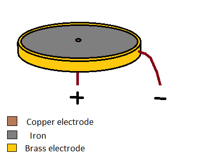

Thanks, an infinite plane would mean there is no in or out, the magnetic field could not complete its loop as I see it. But the disk is not an infinite plane.
You missed the point. If you are one micron above a disk that is 10 cm in radius at distance 5 cm the center, the ends and the center of the disk are very very far away relative to your height above the plane. For all intents and purposes the disk looks like an infinite plane and the B-field locally is parallel to the surface and perpendicular to the radial direction. Now if you keep the distance of 5 cm constant and you go around the circle that picture is maintained. So what do you think the closed loop magnetic field lines look like at least very near the surface of the disk?

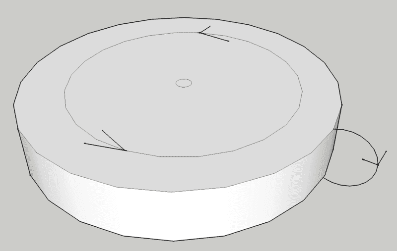

When I visualize your description I see magnetic forces going in a circle around the axis and closing the magnetic loop just outside the periphery of the disk (this is most probably wrong). I am not a scientists and not used to this stuff. The shaft being the positive electrode, what direction would the magnetic lines go? I really have no idea. How do you think the closed loop magnetic field lines look like at least very near the surface of the disk? Is this really a tough question or there is clear yes or no to whether the disk has clearly defined poles? I am a complete amateur, that´s why I came here in hopes to get an answer from a scientist.

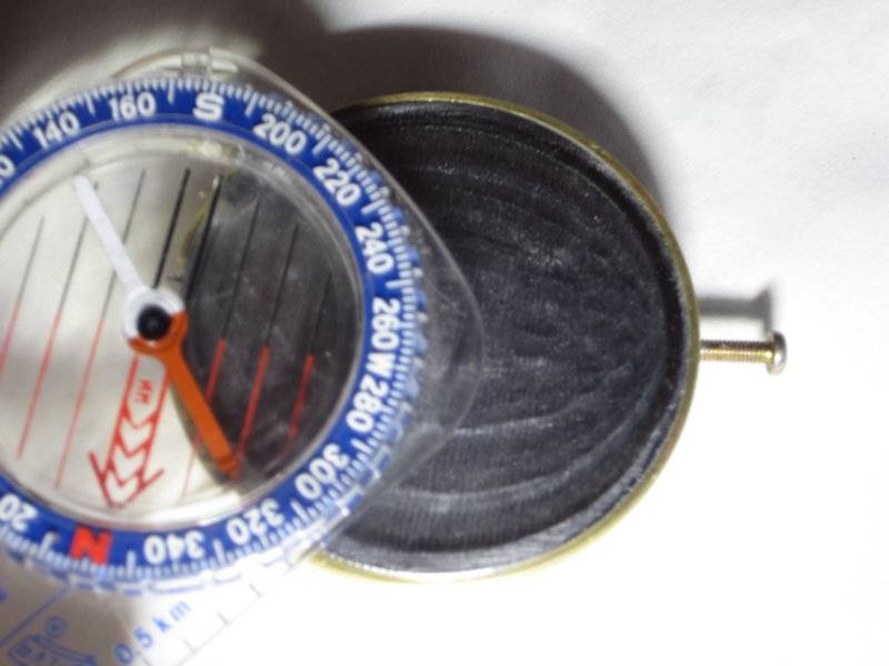

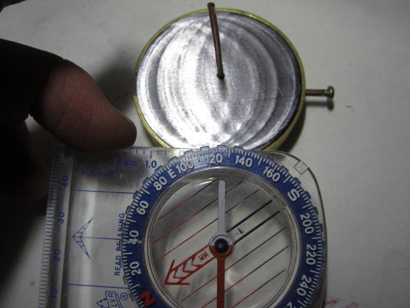

  • #49
No, the radial direction is the direction of the electricity, I need to place a lab magnet in line with the magnetic forces that are produced by the electricity.
  • #50
When the B-field lines close on themselves (as it appears they do above and below your disc), you could place a small bar magnet lined up parallel to the B-field lines, I guess.
Are you familiar with the B-field lines inside a toroid? The circulating B-field inside looks similar to what it probably looks like above your disc...

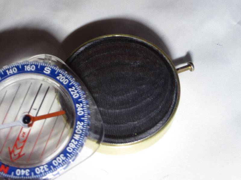

I am not convinced it is the same, if you tell me I am wrong and that you absolutely know this for a fact I will take it for a fact. as I see it this is completely different from my disk. The current in my disk is not turning, it is just going outwards from the axis to the periphery.
  • #52

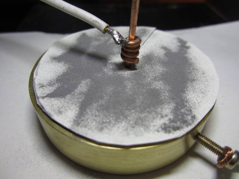

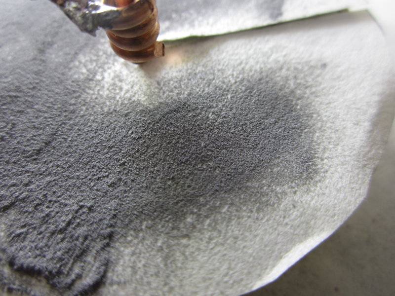

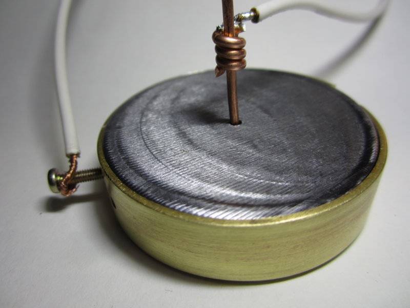

If you are in possession of the device, why not place a piece of cardboard on top of it and sprinkle some iron filings?Edit: Fixed a silly typo
  • #53
gneill said:
If you are in possession of the device, why not place a piece of cardboard on top of it and spring some iron filings?
Yes, I thought of that too, I don´t have the means of passing such a current through the disk, I also need to be able to control the amps so the disk doesn't get too hot

For the above suggested experiment use a flashlight battery as a current source. A size 'AA' Alkaline cell has a shortcircuit current of 8 amps so you would dissipate less than 6 Watts in the disk. Prepare the cardboard and filings on the disk and then make battery contact. Even momentary contact will align the filings. With the stated disk size (5cm Dia, 1cm thick) there will be plenty of time before significant disk heating occurs. It's called either Research or Experimentation. And will be a LOT faster than finding someone who has already done the experiment for you.
Let us know what you find.
