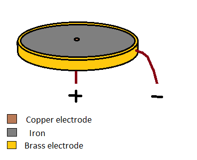

BTW @Magnetosphere -- in the setup as shown in your original diagram, the outer conducting band will not have a substantially greater conductivity compared to the iron disc. So the current distribution you get in the iron disc will not necessarily be mostly radial. I think it will be concentrated between the inner conductor and the tap point on the outer conducting band where the 2nd wire comes off. So you will esentially get current only in the part of the disc between the inner and outer wires, IMO. The iron filings will show that current distribution, instead of swirling like they would for a uniform radial current distribution.
Thanks for the input. The only reason I have a brass ring is because the experiment I am going to conduct has one. I will prepare the iron disk this week and take a few pictures of the iron filings on cardbord.

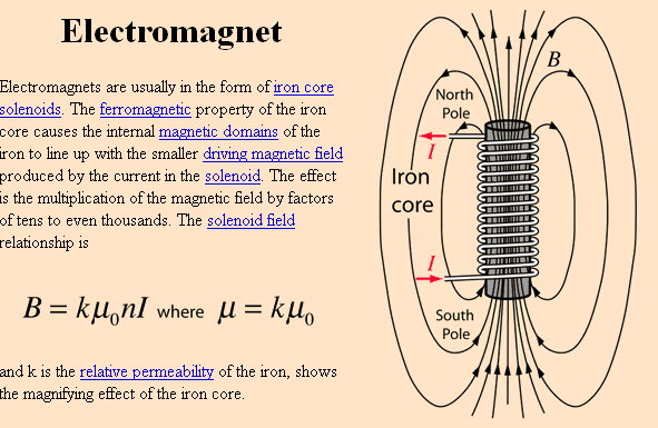

  • #79
Yeah, it doesn't show on my screen and if I go to the page the browser can't find it. I see it though on the second post but I can´t enlarge it.
  • #80
Lets see if this works better for you:
  • #81
Looks great now!
it's good stuff and I believe I even used this when i build my own electromagnet some years ago, but does it somehow help in finding out how the magnetic field looks on my disk? Also, I´ve always wondered, where the current goes "in" is that the positive pole? The thing is, electrons travel from negative to positive right? So what do the arrows indicate, the flow of the electrons? Which would mean that the "in" side is negative and the "out", top in this picture, would be negative?

  • #82
Magnetosphere said:
This discussion really doesn't belong here so i suggest we focus on solving the problem.
I agree. Let's get back on track. As I understand the problem, you came up with this design and you want to know what the magnetic field outside the iron looks like, specifically if it has a north and south pole and where these might be. That is a valid question and has been partially answered in posts up to this one. What might be gathered so far is that a mathematical calculation is tricky and becomes trickier if one considers @berkeman 's observation in #67. You have also indicated most recently in #73 that you are not interested in math that is above you and that you are a visual person, so we have to set math aside. I will be curious to see the results of your iron filings experiment. Also, for a quick and easy way to visualize the magnetic field, you might wish to consider using a "magnaprobe". It is inexpensive and works well in mapping magnetic fields. Do a search on it.

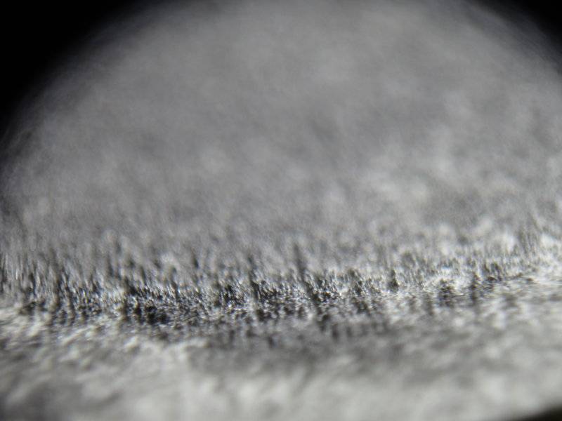

  • #90
Steel disk 5cm diameter. (+) axis, (-) brass ring, power 12 volt car battery 70 amps.
