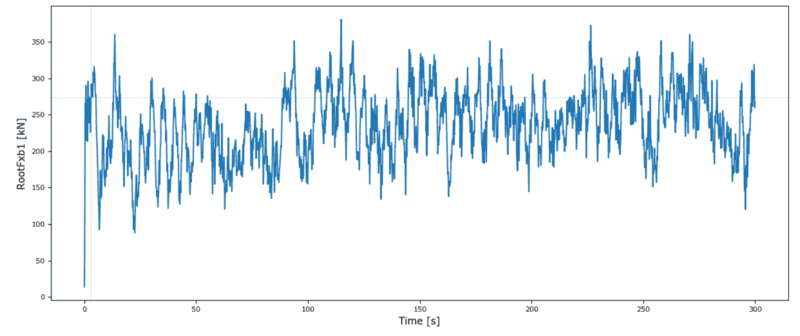

The graph below is of the a time series calculation from a turbulant wind with an average of 12.9mps. This is of the RootFxb1 loading on the blade which is: Blade 1 flapwise shear force at the blade root. The test was ran for 300 seconds. The graph seems to be cyclic in nature, and what im trying to do is calculate cycles to failure from this data.

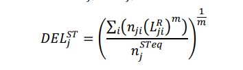

now, i do have a python script that takes this RootFxb1 data and calculates the Damage Equivalent Load. The only issue is that it uses a default value of 1 Hrz for the feq (equivalent frequency of damage equivalent load). I am trying to find the actual frequency from this graph or at least an average to use so i can get a better number. Listed below is the graph and the equations used.
nji = load rangers for a time series cycle
Lri = damage count in a time series
nj^steq = equivalant counts
feq = default 1 Hrz
Then compute the FFT of that data to get the frequency spectrum. Plot the spectrum, then look for the fundamental or peak response.

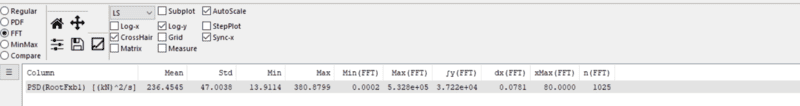

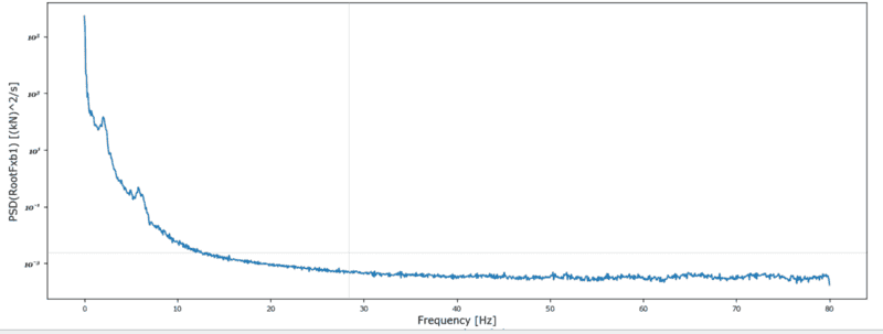

second, in pydatview, a python viewer that can open the openfast timeseries data, there is an option called fft that produces this but i do not know how to read it. the units are strange to me.

fft.png appears to be a power spectrum of the original data set.
The peak on the left is the DC offset of your data set, so freq = 0.
The next peak, partway down the slope, is the fundamental, near freq = 2.0 Hz. That is the frequency value you want.
The next peak is near 6.0 Hz, which I guess is probably the third harmonic of the fundamental.
ok, so 2Hrz is the one i want then. So now in the python script i can use 2 instead of 1, and get DEL back. from there, how do is it possible to get cycles to failure? this concept of cycles to failure is new to me. Im still an engineering student so im not used to it yet haha.

If you eliminate the DC offset of your data, the vertical scale will change, and you may better see the fundamental, (subtract the average of the input data from every element before doing the transform). Zoom in on the fundamental to read the frequency more accurately.

ok, so i found out something. I think the way the fft graph was produced by the software is incorrect?
reasoning:
1/dt is frequency and my time series data is in steps of 0.0063 per cycle. So it should be 158.77 hrz. but that seems really really high because then the total damage is 10,000KN which is impossible. im guessing the 160hrz is how many data points are produced each second to create the original graph.

After the FFT, the frequency spectrum will have half as many elements as the time record analysed. The real input is analysed to become complex data, a cosine and a sine amplitude coefficient for each frequency phasor. Power is the sum of the square of those amplitude coefficients. But the graph may be plotted as amplitude, so it is the root of the mean square = RMS.
t = 0.0063 s/sample
1/t = 158.73 samples/s.
A 300 second recording, at t = 158.73 will have 47,619 samples.
A time record of T=300 seconds duration will result in a frequency resolution of; 1/T = 3.333 mHz per element.
47619 samples / 2 = 23809.5 frequency elements.
23809.5 * 3.333 mHz = 79.357 Hz maximum.
Fmax = 80 Hz is what the FFT gave you.
Now go back through the numbers and do the exact computations to verify the frequency of the fundamental peak.
The vertical axis is not scaled by frequency, but in this case, is corrected for the number of samples analysed by the FFT.
When I said "I didn't understand the units" I meant the units of kn^2\s. I have never seen that kind of unit used with frequency before. I know how units work and the names just fine, but I have never seen kN^2\s before.. force squared over time... It's an interesting unit.
That vertical axis is "PSD(RootFxb1)[(kN)^2/s]"
The real Cos, and imaginary Sin, coefficients from the FFT are amplitude coefficients of force, with units of kN.
They were squared to give (kN)^2, then accumulated, to give the power spectrum of the force, the same units (kN)^2.
Power is proportional to the square of the amplitude.
The "/s" part of the vertical axis units, is the unit of power spectral density; 1/second = 1 Hz; Which shows that power is proportional to the bandwidth in Hz. The area under a PSD graph is the total power, (but plotted here with a log scale).
