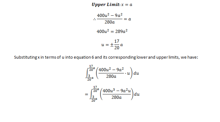

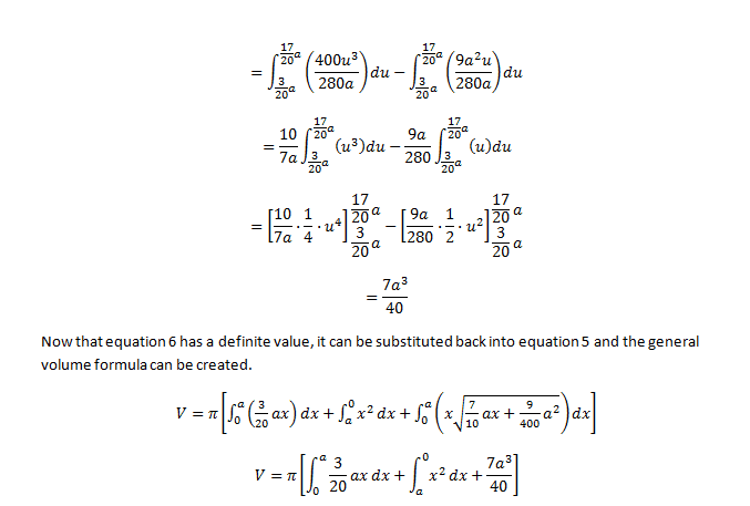

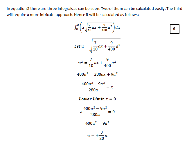

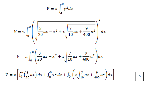

There is a nice equation made by Nobuo Yamamoto which describes the curve of an egg and it is:
(x^2 + y^2)^2 = ax^3 + (3/10)xy^2, where a is the length of the major axis of the egg.
Solve this equation for y, we get:
y=+/- sqrt((3/20)ax - x^2 + xsqrt((7/10)ax + (9/400)a^2))

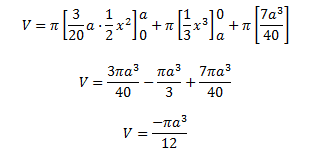

When I rotate the function around the x-axis by 2(pi), the result is a negative volume of (-1)((pi)(a^3))/12.
I don't know what I am doing wrong, or how I can fix this problem.
Can someone please help me out on this?

It looks like you didn't solve for ##y## correctly. I get
$$y = \sqrt{\left(\frac b2\right)x-x^2+x\sqrt{\left(\frac b2\right)^2+(a-b)x}}$$ where ##b=3/10##.
To integrate the term of the form ##x\sqrt{c+dx}##, try using the substitution ##u=c+dx##.
OK, so you have a typo in the equation in your first post. Your expression for ##y## is correct, but you didn't evaluate the third integral correctly.
