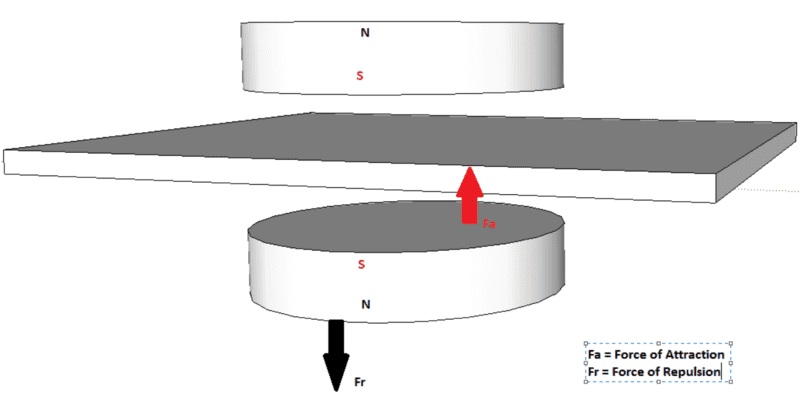

As my first post here I would like to open with a situation I have been struggling with
I have attached a simple diagram of my problem
I have 2 cylindrial N52 neodymium magnets axially aligned with each other with opposite poles facing each other.
in the middle of both magnets there is a HiperCo 50 metal
The idea is that the net force on each magnet is zero. That is, the force of repulsion between the magnets and the force of attraction between magnet and metal (hiperco alloy) cancel one another.

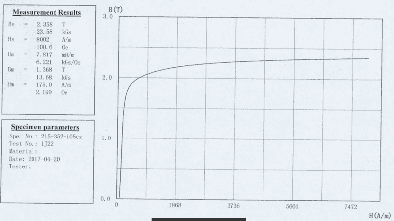

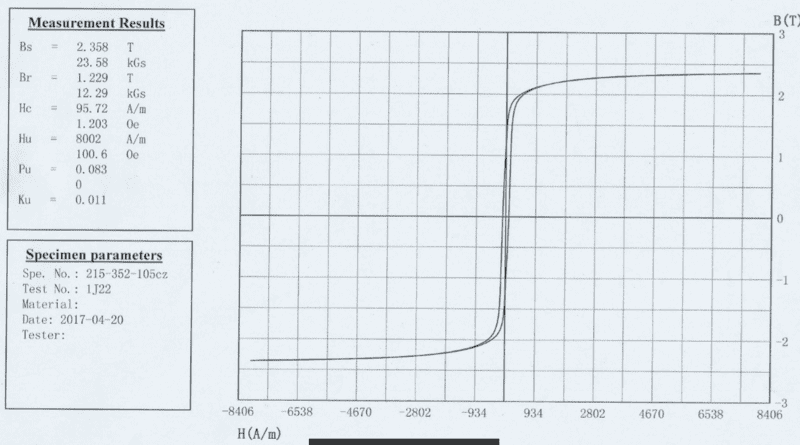

I will very much appreciate if someone can share some math that allows to calculate the thickness required on the hiperco metal to achieve Fa and Fr to cancel.
I have also attached BH graph of the hipeco alloy
best regards,
Martin

If the plate is thick enough not to saturate, I don't think much of the field from one magnet will affect the other magnet. So the magnets will both stick to the sheet.
If the sheet is very thin and can saturate, then I think the math gets pretty complicated, and you may just need to simulate the setup to get an idea of the behaviors.
A better way to do this, IMO, is to cut a hole in the sheet between the magnets to let some field through so the magnets can influence each other. Experiment with the diameter of the hole versus the magnet diameters and spacings to see if you can arrive at a stable configuration...

It is not "all or nothing", but if the plate is thick, the influence of the magnets on each other will be very small.

I was doing some simulation with QuickField. I used the BH curved provided by the manufacturer to configure the behaviour of permeability of the metal plate.
In the simulation I was able to reduce the force to zero by varing the thickness of the plate. So, if the simulation is correct, this should mean that there is a portion of the field passing through the plate influencing the magnet on the other side.
This would prove what you are stating here, mfb.
