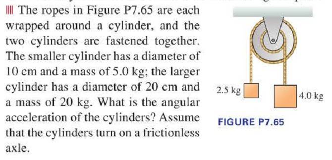

The problem
Direct imgur link to problem: http://i.imgur.com/QCc0zj6.jpg
\alpha = \frac{\tau_{net}}{I}
I = \frac{1}{2}MR^2
\tau = rF = rmg
I have figured that the moment of inertia of the entire system must be used for both torques pulling on the system, so the one I is
I = \frac{1}{2}(5.0\times (0.05)^2 + 20\times (0.10)^2)
So shouldn't the net angular acceleration just be the net torque of the two competing weights divided by the moment of inertia of the entire system?
\frac{0.10\times 2.5\times 9.8 + (- 0.05 \times 4.0 \times 9.8)}{\frac{1}{2}(5.0\times (0.05)^2 + 20\times (0.10)^2)} \approx 4.6 \frac{rad}{s^2}
[The second torque trying to turn CW, so therefore is negative torque.]
However, the answer from the back of the text says 3.5 \frac{rad}{s^2}
What am I doing wrong? Do I need to consider this is terms of the tensions in the ropes instead? When considering the torque applied to the system by one hanging weight, does the other hanging weight count towards the moment of the inertia of the system?

Yes. It is the rope tension that acts on the cylinders, not the weight of the hanging masses.
Hint: Apply Newton's 2nd law three times.

Are the tensions in the ropes equal? The masses have different accelerations, though one is twice the other.

Since the angular acceleration for the entire system is the same throughout
\frac{\tau_1}{I} = \frac{\tau_2}{I} ?
\frac{r_1(m_1a_1+m_1g)}{I} = \frac{r_2(-m_2 \frac{1}{2}a_1+m_2g)}{I}
And now I just solve for a, and then solve for the angular acceleration knowing the radii...?
I am really struggling with this one.
I can see that the angular acceleration will be the same for the whole system, and so the tangential acceleration of the weight on the inner cylinder will be -1/2 the tangential acceleration of the weight on the outer cylinder.
I know that the net torque divided by the moment of inertia of the entire system will get me the angular acceleration. I am just struggling to resolve how the forces and torque are interacting to produce the net torque.
So, net torque will be +ve torque from 2.5 kg weight - 0.50 Nm from friction - torque from 4.0 kg weight. I am assuming that the CCW is the positive direction.
Ok, so the force creating the torque will be the tension in the rope minus the weight on the end of the rope.
I get T_1 - 24.5 = 2.5a_1 and T_2 - 39.2 = 4.0a_2, but a_2 = -\frac{1}{2}a_1 so T_2 - 39.2 = -2.0a_1
But I don't think the two tensions in the ropes are the same, they are different ropes, and the masses that they are supporting are undergoing differing linear accelerations.
I've tried T_2 = \frac{\tau_{net}}{r_2} is this correct? Is the second tension raising the other weight the result of the overall torque divided by the radius of that particular cylinder. But subbing back into other equations gives an acceleration for the first dropping weight greater than gravity.
I AM DYING HERE, someone please help me!

The tensions are not equal.
Yes, the acceleration of one mass is twice the other. Which has the greater acceleration ?

True, there is only one angular acceleration for the combined cylinders. However, it's the difference (or the sum) of the torques that produces the angular acceleration. Those quantities are not equal.

Exactly. You'll need to relate the accelerations of the masses with the angular acceleration of the cylinder.
To make things easier, I recommend that you write equations for each mass and the cylinder, expressing Newton's 2nd law. That will give you three equations.
Using the relationship between the linear accelerations of the masses and the angular acceleration of the cylinder, you should be able to solve for the angular acceleration. (And you can solve for the other unknowns, if you like, such as the tension in the rope and the accelerations of the masses.)
Express everything symbolically. Don't plug in numbers until the very end.
