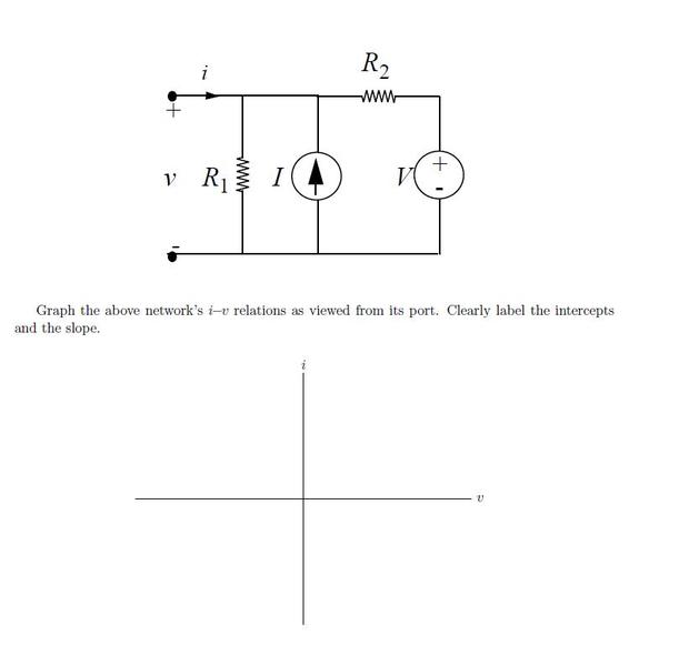

See Figure
I honestly don't know how to start this problem, I tried cutting out the current source and I'm thinking I should get something like a voltage divider. Does that help in any way?
A slight push to get things rolling would be great!

You can start by plotting a couple discrete points on the graph to start to get a feel for what is going to happen. What is Iin if Vin=0? What is Iin if Vin=V (why does the voltage source have two negative "-" terminals?) ? What is Iin if Vin=(-V)?
Then, I'd just write the KCL equation for the input node, and look to see if you can fill out the rest of the plot using that.
You could also transform the current source into a resistor in series with a voltage source. Then, you'd have a simple set of mesh equations that describe the system.

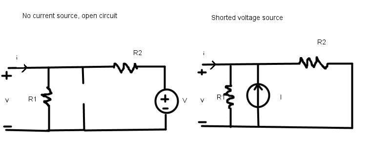

Here is a sketch of my attempt at superposition, I'm still not sure how to work out my answers from this.

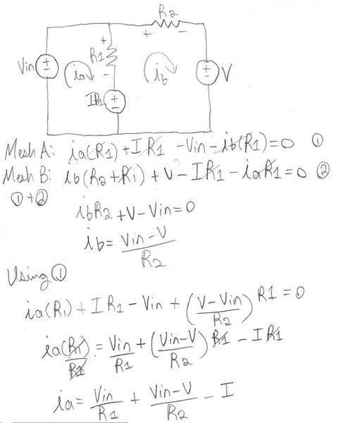

Don't you think it's easier to write two mesh loops with this set up and then use the system of two equations to solve for I1 in terms of some arbitrary Vin?

EDIT: Can someone tell me if my current efforts at using superposition are correct?

Yes, I did mean for Vin and Iin to be at the single port at the left. And no, Iin is not zero when Vin is zero. Why not?

Just picture the Vin=0 case as if you shorted the input terminals. You are correct that there will be no current through the resistor R1, since there is no voltage across it. But what current flows through your short circuit wire? There's current coming from the voltage source on the left through its resistor, and the current source in the middle is an ideal current source -- it puts out its current no matter what the voltage is across it...

Yes! Good. So that's one point on your graph.
Now set Vin = V (the same as the voltage source). What does that do to the current through the resistor that is in series with the voltage source? That should give you a 2nd point on the graph.
Then try writing the KCL for the input port. Does that help?

First, sorry, I missed a sign error in your previous post. When Vin=0, Iin doesn't equal I, it equals -I. Why?
Second, when Vin=V, why would there be current through R2? Remember, when writing the KCL, you are using voltage differences across resistors...
Alrighty, I was getting real confused so I decided to start from scratch and do a mesh analysis of this circuit and here's what I got. (See Figure)
Now if that is indeed correct how do I go about plotting the i-v curve from that?
