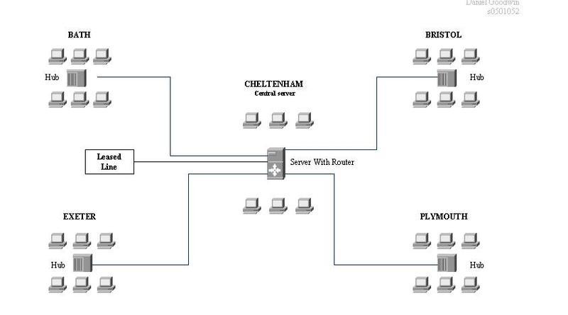

An estate agency with five branches in the south west of England: Bath, Bristol, Cheltenham, Exeter, and Plymouth. Each branch has three dpeartments; the sales department, which may employ up to twelve people; the accounts department which may employ up to three people; the mortgages department which may also employ up to 3 people. Each branch occupies one building. As part of a general upgrade to the computing facilities, the estate agency requires that the computers for all employees in each branch be networked, and that all branches be networked.

Right i don't neccesarily want an answer here, i just want someone to say if I am going along the right lines around here. I am thinking at the moment that the most appropriate solution to this answer would be to have a set of LAN's in each of the branches that the company has. Then using routers and hubs (or small switches) to help create a WAN, allowing connection between the branches themselves, and also using a leased line for added security for the WAN. The question doesn't say anything about the size of the company, nor the amount of money that the company wishes to spend so I am assuming that a leased line would be alright? There was also the (more probable) possibility of using VPN but within the lectures, the lecturer had never even mention VPN so I am assuming that he doesn't want us to look into that as the course is for people who have never done anything within Networks before.
Is that all sounding correct? Like i said i want to know if this is the right sort of network to be doing so that i can get on with writing the report.

Would this theoretically work? (it's a drawing of what the network could look like - attatched) it's been done quickly and am not sure if it would work, or if anything is missing.. i have no doubt that something is missing.

Where are the firewalls located? How is connection to the Internet and outside e-mail accomplished? How are the connections between the central hub and the four field offices accomplished (like T1, etc.)?

Each branch should at least have a firewalled and VPN enabled router to securely separate LAN and WAN communications.
Leased line option
Each branch needs a leased line to the location that hosts the server(s).
Routers are not essential but switches should be the minimum. There are simply too many computers connected to warrant the usage of hubs. Assuming that the business uses the internet, and which business does not nowadays, you would need a gateway to the internet. There are two options, one is to install a router at the location that hosts the server(s) or you could install a router in each branch connecting directly to the internet.
Am I right in thinking that to connect to the internet it's possible to get a connection from the router at the central server to the ISP itself. And that the other branches can connect through to the internet from connecting to the router aswell? And that the firewall would be between the ISP and the server?
