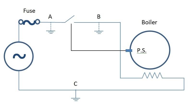

Suppose you have a boiler to produce steam. The heater of the boiler is controlled by a pressure switch inside the boiler. When the pressure reaches a certain level it opens a switch, shutting off the heat until the pressure is reduced.
Initially let's assume there are no grounds in the circuit and the circuit works fine. Years go by, even decades, and eventually the insulation at point A gets worn away and it makes a connection with ground. What happens? Nothing and nobody is even aware that it happened. More time goes by and the same thing happens to the insulation a point B. Now what happens - the boiler explodes.
But suppose there was a ground at point C from the beginning. As soon as the ground develops at point A, the fuse blows and an electrician investigates to find out why the fuse blew and fixes the problem.

One more thing, I think the OP, with the level of understanding they have tried to illustrate, might not understand how the ground at C and A might constitute a short, if they do not understand grounding.. however I like the example you brought forward I have kept it.
But to the OP, if you look at the diagram that Skeptic posted, assume you do not have a ground at C, but you do have grounds at A and B.. electric current tends to return to the source.. it doesn't want to go to ground as many incorrectly assume, rather ground is the lowest impedance path back to source
You posted: How does the circuit not flow to ground initially? I mean how does it detect that the path has less resistance?
In response to this, current tends to return to the source through all circuit paths, but with a limited amount of voltage, current cannot take a path through ground to return to the source if there is not point for the current to RE ENTER the circuit.. now if you look at what Skeptic posted imagine grounds at A and B. Current has a way to leave the circuit (at A) and re enter (at B). The infinite impedance of the open switch presents too large an impedance for the current to flow, but there is much less resistance to ground, so this is the path it takes.. even with the boiler pressure maintaining that switch. Therefore the pressure builds until it explodes... On the other hand, If you have C point grounded initially... the circuit operates fine, because no current will go to this point initially (why would it, since current tends to flow to source, not to ground?) But once A becomes grounded, current can leave through A, return on C, and return to source... this nullifies the impedance of the boiler heater, and the only current limiting factors are that of the circuit wire, and that of ground which are low. Now rather than waiting for B to ground and cause disaster... the circuit will blow the fuse.
