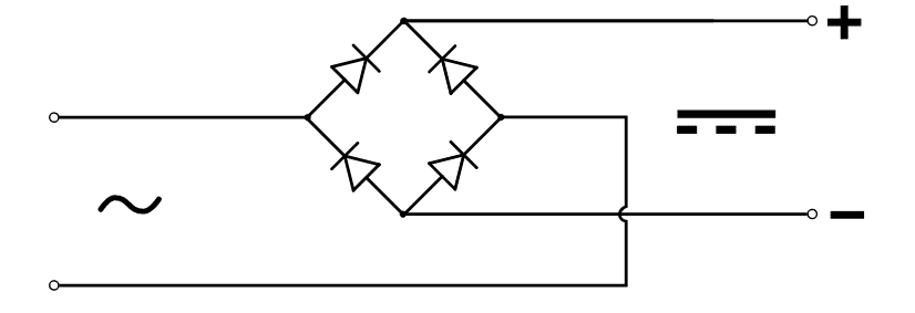

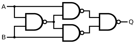

This wikipedia article is pretty good : https://en.wikipedia.org/wiki/Diode_bridge
There is a non-planar crossover (the little half circle) in this bridge circuit ##-## that crosser can be replaced with 3 XOR gates to make it planar, arranged as shown here:
. . . and each those can be relaced by 4 NAND gates arranged as follows:
That can matter in micro-circuits, but generally doesn't matter on a breadboard circuit.

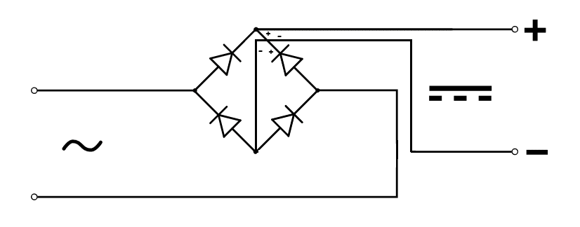

There is a non-planar crossover (the little half circle) in this bridge circuit ##-## that crosser can be replaced with 4 XOR gates to make it planar, arranged as shown here:
"... that crosser can be replaced with 4 XOR gates to make it planar, arranged as shown here:"
There are only three XOR gates shown.
I don't see why a diode bridge was suggested in the context of the OP, anyway. It certainly wouldn't work for an appliance requiring an AC supply, and neither would using logic gates as part of a diode bridge in a power circuit.

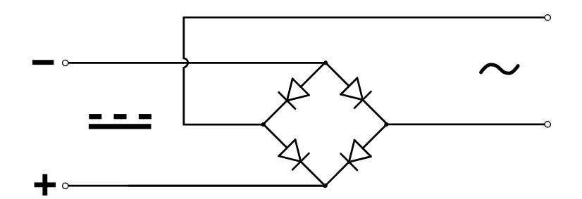

You right ##-## it's 3 XORs, 4 NANDs each to replace them, and 4 diodes in the bridge ##-## thanks for the correction ##-## I'll edit the post ##-## as for appliances that use bridge rectifiers to convert AC to full-wave-rectified DC, there are many such devices.
Regarding using logic gates as part of the bridge circuit, they could be used in the DC part of the circuit to allow a planar crossover, like this:
The 3 XOR gates could go where the left-tilted X with the adjacent - + and + - labels is in the circuit illustration.
