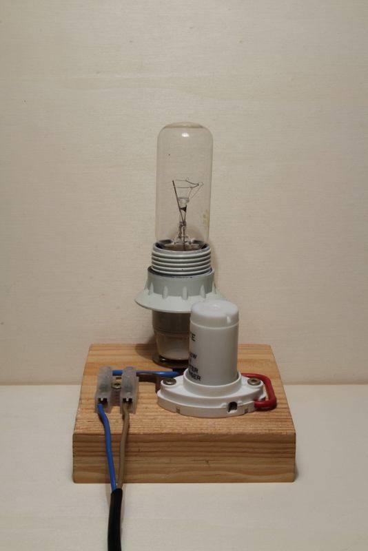

Maybe it depends on what you're connecting to the socket. Here's a simple blinker that uses a fluorescent lamp starter (bimetallic contacts in argon) connected to an incandescent lamp bulb. The blink cycle goes as follows: when power is turned on, the starter begins to warm up, and when it warms up enough, the contacts connect, and the lamp lights up; then the starter cools while the lamp is on, and when it cools enough, the contacts disconnect, and the lamp goes out; then the contacts heat up again, and soon return to a connected state, and the lamp lights again.
:wink:
If the current-carrying capacity of the 2 devices is about equal, and you swap the blue and brown wires, that may change which device gets blown first in the event of excessive current being applied.
