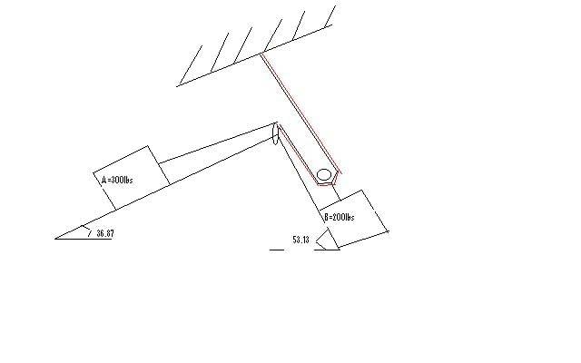

the blocks shown in the figure are connected by flexible, inextensible cords passing over frictionless pulleys. at A, the coefficient fiction is 0.30 while at B, it is 0.40. compute the magnitude and direction of the friction forces and each block.
for block A=
T-mgsin53.13-Fmax=0
Fmax=0.3(300cos53.13)
for block B=
T-mgsin36.87-Fmax=0
Fmax=0.40(200cos36.87)
m(1)g-T=m(2)
for A:
Fmax=(o.30)(300cos53.13)
Fmax=54
T= 300(9.81)sin53.13
T=2354.4
for B :
Fmax=0.4(200cos36.87)
Fmax=54
T=200(9.81)sin36.87
T=1177.20
m1g-T=m2a
a=(2943-T)/200
a=244.3
AM i RiGHT ? please help thnx .. I am too confuse
Hello!
Are the blocks to remain static? Does this question keep them stationary?
Daniel
Then this
m1g-T=m2a
is impossible, since a = 0.
So try again, on that point alone.
sorry it is kenetic..
for A:
Fmax=μk(m1)gcos53.13
54=μk(m1)gcos53.13
μk=0.03
T-300(9.81)sin53.13-μk(300)9.81cos53.13=(300)a eq(1)
200g-T=200a eq(2)
subtitute (1) and (2) to find a
a=-3.79
for block B:
Fmax=μk(m2)gcos36.87
64=μk(m2)gcos36.87
μk=0.04
T-200(9.81)sin36.87-μk(200)9.81cos36.87=(200)a eq(1)
300g-T=300a eq(2)
to find a
a=0.2AM i DOiNG RiGHT ?? please comment .. I am lack of knowledge ..
