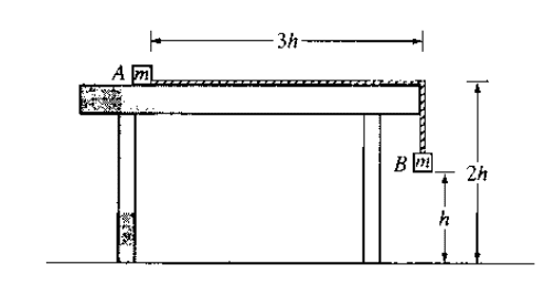

Two small blocks, each of mass m, are connected by a string of constant length 4h and negligible mass. Block A is placed on a very rough tabletop as shown below, and block B hangs over the edge of the table. The tabletop is a distance 2h above the floor. Block A is then released from rest at a distance h above the floor at time t = 0 and the system begins to move. The coefficient of kinetic friction is μk.
Express all algebraic answers in terms of μk, h, m1, m2, , and g.
Diagram of a block A on a horizontal table connected by a string over the edge to hanging block B; the table top is 2h above the floor, B is h above the floor, and a horizontal dimension of 3h is marked.
A) Write equations for the sum of forces in both directions.
