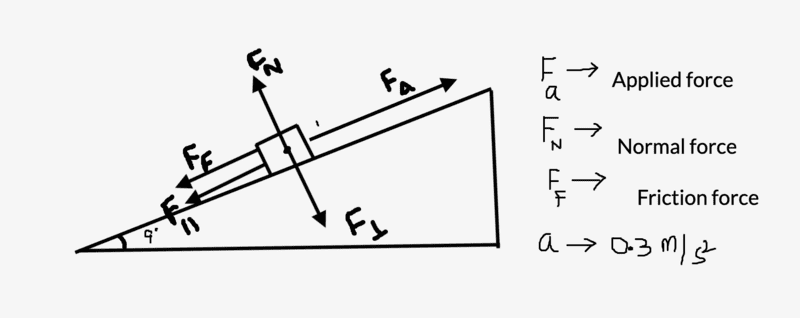

A 65 kg cyclist on a 10 kg bicycle is moving uphill on a 9° slope. How much force does he provide
if the bicycle slows at a rate of 0.3 m/s2?
Applied force - frictional force - parallel force component due to gravity = ma
How to find frictional force when coefficient of friction is not given?
If the bicycle wheels roll without slipping or are not on the verge of slipping, the coefficients of friction are irrelevant. You have the acceleration, so what is the net force on the bicycle + cyclist system? What is the net force just on the bicycle?

So you mean there is no frictional force acting on the system?

Not what he means.
He said that you don't need to know the frictional force to solve this problem.

But it’s asking for the force the rider provides, not the net force.
I feel like “ignore friction” should be right in the problem statement on this one?

@paulimerci -- Please post a new thread with this problem and show your work.
As you can see from the replies, this is most likely not a problem of something sliding up or down an inclined plane with sliding friction coming into play. If a bicyclist is pedaling up a slope and slowing down, there is a force that the bicyclist is applying by pedaling but it's not enough force to keep them from slowing down on the slope. So in your FBD, you should leave off any retarding force due to sliding friction, and focus on what force the bicyclist needs to exert to result in the motion specified in the problem.

You are suffering from a common confusion between friction and rolling resistance. The relevant equation posted takes friction as always something opposing motion, which is incorrect.
Please read https://www.physicsforums.com/insights/frequently-made-errors-mechanics-friction/ before reposting the thread .
