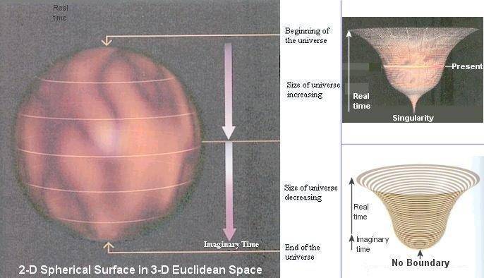

I am confused by the diagram in the lower-right corner.
Why do we use imaginary time only for the beginning of the Universe?
What happens if we do the same for the whole history?
So, Hawking says that the BB singularity is not a real one and we can get rid of it using some mathematical transformation?
Well, it is definitely a proposal of different physics, not just a mathematical transformation of current physics. It's just proposing that it is conceivable you might have a beginning without an actual singularity.
I understand, but how it is different from say Kruskal–Szekeres coordinates? They also create some 'imaginary' time and get rid of the singularity on the horizon?
(Crying to Hawking with a voice of Homer Simpson: boooring! :) )
Well, the difference is that the "singularity" at the horizon of a black hole is a coordinate artifact, not a real singularity (the curvature doesn't do anything strange at the horizon of a black hole). The singularity in the finite past for any universe obeying General Relativity is coordinate-independent (which is one big reason why I think GR must break down on small scales).
I am also confused by the word "imaginary"
First of all, our normal time is sort of "imaginary" because our space is pseudo-euclidean.
Is Hawking "imaginary" time because it is "differently scaled" (but collinear) to the "real" one?
Or it is imaginary because the ratio to real time is "i"? In that case "imaginary" "imaginary" time is real time :) so there is 4D *euclidean* space, but there is a *illusionary* property called "time", which emerges at macroscopic level and is perceived by the observers, and for some reason, the direction of that "time" is *i (imaginary) to the real one?
