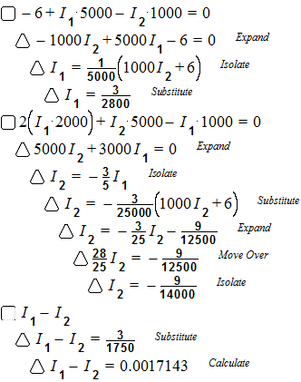

Given the circuit diagram above, I am interested in finding the current ia. Using mesh analysis, I determined it to be 1.71mA, but nodal analysis results in a value of 2.25mA. Solution attempts provided below. I think the issue is in my nodal analysis approach.
Mesh Analysis..I1 is the left mesh, I2 the right mesh.
Nodal analysis attempt...current calculation at the bottom.

For the node equation, check your substitution for v1: Note that the 6 V source is connected through a resistor to the reference potential.
I tried to take that into account on one of my attempts, the voltage v1 as 3-v provides the correct value for current. I was unsure if I'm on solid ground to do that.
You're on the right track. But how to justify your substitution?
Consider that you have a term in your node equation for the current that passes through the "v1" resistor. How would you express v1 in terms of that current?
I see v1 given as
Which allows me to plug in and
Looks good.
Thank you.
