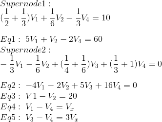

Write the nodal equations
Could someone check my answer please ?

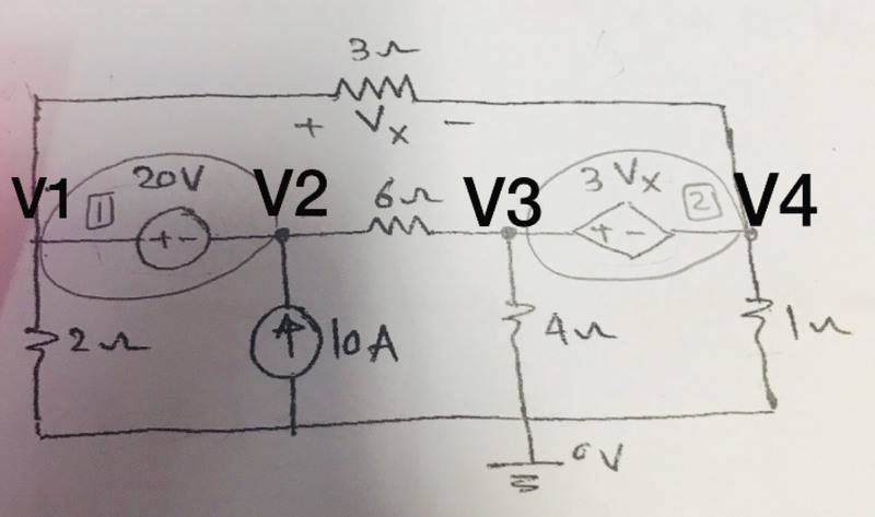

Can you label your image to locate the various node voltages? I can guess that V1 and V2 are associated with the two supernodes, but if so, I don't understand the introduction of V3 and V4 as separate nodes.
Okay. Note that ##V_2## and ##V_3## are both part of supernodes. You want to associate only one potential variable with a given supernode.
Note that your ##V_2 = V_1 - 20##, and ##V_3 = V_4 + 3V_x##.

Should I substitute these equations in Eq#2 ?
Yes. Both Eq#1 and Eq#2. You should end up with two node equations with only two unknowns.

gneill said:
Yes. Both Eq#1 and Eq#3. You should end up with two node equations with only two unknowns.
