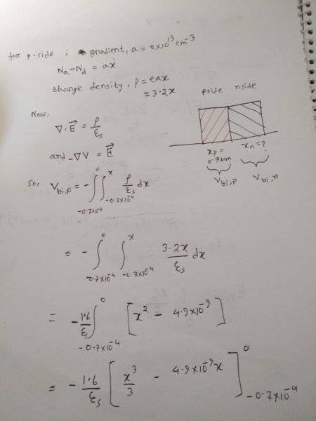

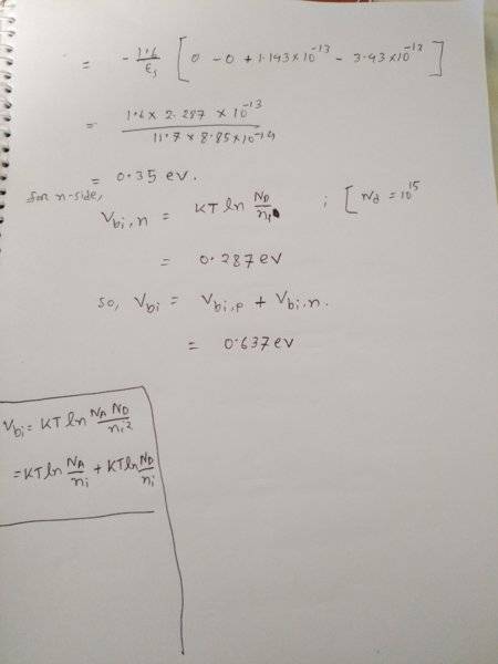

Hello guys, I stumbled upon this problem while studying non uniformly distributed pn junctions and finding difficulty solving this. Any help will be greatly appreciated.
A diffused silicon p-n junction has a linearly graded junction on the p side with a = 2 x10^19 cm-4, and a uniform doping of 10^15 cm-3 on the n side. If the depletion width on the p side is 0.7 micro meter at zero bias, find the total depletion width, built-in potential, and maximum electric field at zero bias.

Thanks eq1 for your reply. I tried to solve the built in potential part, though not sure if it's the correct approach. The gradient is given in the question as the parameter 'a' . the problem is from Neamen's semiconductor physics and devices exercise. I attached the photos of my solution. Please share your valuable thoughts on this.
Handwritten derivation of built-in potential for a p-n junction, with terms for the p-side and n-side combined to give a total of about 0.637 eV, and a boxed general expression Vbi = kT ln(NA ND / ni^2).

  • Handwritten derivation of built-in potential for a p-n junction with linear doping gradient a = 2x10^19 cm^-4: charge density rho = eax = 3.2x, Poisson integral of rho/epsilon_s from -0.7x10^-4 to 0 and -0.7x10^-4 to x, with a small sketch of p-side and n-side regions.

I didn't understand the first two images, but the third looks like it has the correct approach; rho (charge density) is modified to include the ax term (it has a linear dependency and is not just a constant), then integrate charge to get the E-field and integrate that to get the built-in potential. I haven't checked the math or the constants you plugged in though. (The obvious thing is there needs to be an x^2 term in E-field which I saw, so I suspect it's ok)
