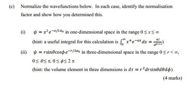

2. Homework Equations [/B]
Uploaded as a picture as it's pretty hard to type out
So to normalise a wavefunction it has to equal 1 when squared.
A is the normalisation factor so we have:
A.x2e-x/2a0.x2e-x/2a0 = 1
∫ψ*ψdx = A2∫x4e-axdx = 1
Then I've been given the integral of this between 0 and ∞: ∫xne-axdx = n!/an+1
∫ψ*ψdx = A2.4!/a5
= A2.24/a5
A = √a5/24
Have I done this right? I don't even know where to start with (ii). Any help would be greatly appreciated!

"." is an unusual multiplication sign, "*" is better (or use LaTeX for the best result).
(i) looks right.
(ii) is like (i), just with a more complicated function and in three dimensions, but the approach is exactly the same.
