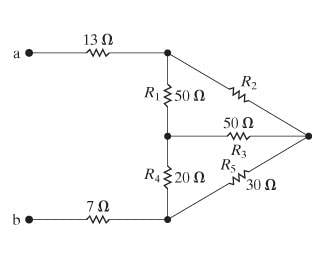

A.) Simplify the circuit (Figure 1) by using a Y-to-Δ transformation involving the resistors R2, R3, and R5 as shown in (Figure 2) . Determine the resistances of the equivalent Δ.
B.) Determine the equivalent resistance Rab in the circuit.
Hopefully these two figures show up. If not, just say so and I'll try to fix them.
Figure 1.
Circuit schematic with terminals a and b; 13 Ω and 7 Ω series resistors, R1 50 Ω, R4 20 Ω, R2, R3 50 Ω and R5 30 Ω forming a bridge-like network between the two nodes.

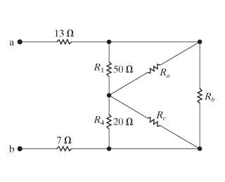

Figure 2.
Circuit schematic with terminals a and b: 13 Ω resistor in series at the top, R1 = 50 Ω, R2 and R3 Y-branch resistors meeting at a central node, R4 = 20 Ω, 7 Ω resistor at the bottom, and R5 (Rb) on the right side of the triangle.
I've simplified the circuit and found:
Ra = 154 Ω
Rb = 92.4 Ω
Rc = 18 Ω 118 Ω
I know these values are correct. My problem is with part B. Now that I've got the resistance of the 3 new resistors, I'm unsure about how to find the equivalent resistance between terminals a and b. What about this Y-to-Δ transformation makes this circuit easier to work with?
It looks like Ra and R1 are in parallel. R4 is in parallel with Rc.
Does that help?
Does that help?
R1 looks like it is in parallel with Ra and Rb+Rc, which wouldn't be a problem except that there's a node connecting Rb to the other side of R4, which is in series with R1.

cnh1995 said:
As magoo showed, you can see it converts the network into a simplified circuit (series or parallel resistances).
Oh I see it now. I see that R1 and Ra are in parallel, and it looks like R4 and Rc are in parallel too, as Magoo said.

I don't think your 3 values for Ra, Rb and Rc are corrrect. One can work backwards with a delta to wye transformation and get the original R2, R3 and R5. If I do this I get:
53.82
10.48
6.29
Since you didn't give a value for R2 in post #1 we can't compare one of the three to it, but two of the three just calculated should equal 50 and 30 (R3 and R5); they don't. How do you know your values are correct?
My apologies, I had forgotten that they don't give us the value of R2 in the figure, but in the previous question. I assume it changes for every student and they didn't want to make a different figure for each person.
For this question R2 = 39 Ω.
Also, it appears I made a typo in my original post. Rc = 118 Ω, not 18.

Alright, I finally got the right answer.
R1 in parallel with Ra: R1a= 37.745 Ω
R4 in parallel with Rc: R4c= 17.101 Ω
R1a4c in parallel with Rb: R1a4cb = 34.417 Ω
Req between terminals a and b: Req = 34.417 + 7 + 13 = 54.417 Ω
Thanks all. Sorry for the confusion.
