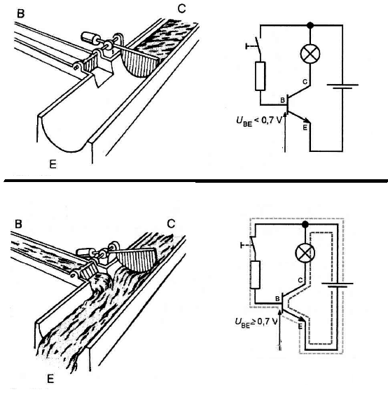

Yes, transistors themselves do NOT amplify signals. But what you need is to understands what amplification really means.
Amplifier is a device that allow as control the flow of "high power" by helps of a low power. To the Amplifier effect occurred, two things are necessary: source of energy (power supply) and a device for controlling the flow of this energy - > the amplifier.
So transistor only control the flow of a energy.

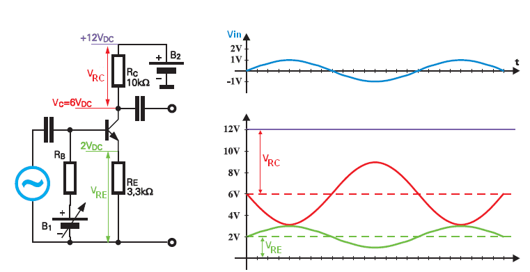

See the example of a common emitter amplifier
At first we bias the transistor in linear active region.
Next we connect the input signal 2V peak to peak AC signal.
The DC voltage at base is equal Vb=2.6V, and emitter dc-voltage is 2V.
So if we apply the ac signal to the base. The dc-voltage will be change from 2.6V + 1V = 3.6V and 2.6V - 1V = 1.6V. So the base voltage will change from 3.6V to 1.6V in "rhythm" of a ac input signal.
These changes will result that the emitter voltage will also change. From 3V to 1V. This will result the change in emitter and in collector current by (3V) 0.9mA to 0.3mA (1V). And this change in collector current will cause change in VRc voltage, between 9V to 3V. We have a three times larger change in VRc voltage because Rc is three times larger then Re resistor.
So we can say that amplifier "modulated" power supply energy in the rhythm of a input signal.
Any more questions?

i love that hydraulic or aqueduct analogy.
perhaps to answer (in a hand wave) the OP, is that the collector-base junction is reverse biased. so even though a big voltage would like to push some charge through that junction, it cannot because of the depletion region right at the CB junction. that region is less depleted when there are charge carriers available from current flowing in from the base, and the base is very thin.
It's kind of like the following analogy. We use the term "magnifying glass" to describe a device making it easier in reading fine print. The glass is said to "magnify the print". This is not a problem if we understand the definition of the word "magnify". The glass does not literally increase the size of the print at all. It merely bends and focuses the light rays in a manner which creates a virtual image which is a scaled up facsimile of the print.
Likewise a transistor, bjt or FET, is not literally increasing the magnitude of the input current and/or voltage. Rather it controls or modulates the current delivered from an independent power source, be it a battery, ac outlet, car alternator, etc. The word "amplify" is understood to mean that the device along with an independent power supply form a signal which is the scaled up facsimile of the input signal. Two scope probes will affirm that if we view the input and output signals simultaneously, they co-exist. The output is scaled up and identical to the input, but the input still remains unchanged.
To amplify is to create a replica scaled up in magnitude. A transistor does just that. It does not literally "increase" the current/voltage of the signal.
It is very analogous to a magnifying glass that merely creates a virtual image scaled up but otherwise like the original image, which remains unchanged.
