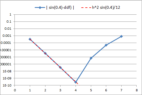

In summary: And h is not plotted on a log scale.)The black curve in post #7 is the correct plot: it is the error ##|f_{num}(0.4,h)-(-sin(0.4))|\ ## against h (on a log scale). As you can see for yourself, it starts at the correct value ##10^{-3}## (for k = 1, as I am lazy and like Excel) and then rises as h decreases until it gets overwhelmed by the double precision issue. So your plot is not right, but you have done a lot of work and are close. Look again at the values in post #9 and what I did with them in post #7.I don't have

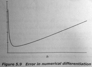

I am trying to estimate the second derivative of ##sin(x)## at ##0.4## for ##h=10^{-k}, \ \ k=1, 2, ..., 20## using:
$$\frac{f(x+h)-2f(x)+f(x-h)}{h^2}, \ \ (1)$$
I know the exact value has to be ##f''(0.4)=-sin(0.4)= -0.389418342308651.##
I also want to plot the error as a function ##h## in Matlab.

And for the error I get all zeros, so it is not possible to plot error vs h. But I believe the graph should look something like this image:
So, what do I need to do here?
Any help would be greatly appreciated.

In fact the exercise can be done with excel comfortably as well and it gives the (Phyz) expected result -- up to k = 4 , so when ##h^4 = 10^{-16}##
Not unreasonable: we are subtracting ##\approx \cos(x+h/2)## from ## \approx \cos(x - h/2)##

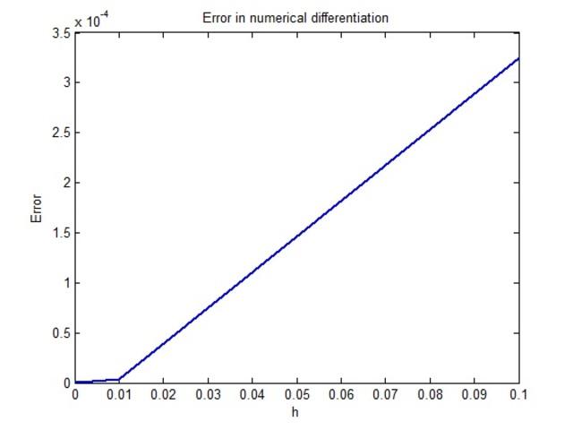

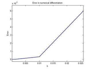

Anyway, I have now plotted the error function against ##h##:
Is it about right? Would you say it looks anything like the generic shape of the error function as illustrated by the figure in my first post?
I miss the upswing when h is close to zero. Don't you plot h < 0.001 ?
Code:
k   h         | sin(0.4) - ddif |
1 0.1          0.000324407
2 0.01         3.24514E-06
3 0.001        3.24324E-08
4 0.0001       2.91428E-10
5 0.00001      7.10251E-07
6 0.000001     4.78947E-05
7 0.0000001    0.000840284
8 0.00000001   0.16569317
Why is that? I plotted all the values, here's are the values used:

Looks like you plotted ##\
\frac{h^2 sin(0.4)}{12}\ ## ? That is not the error ! That's the predicted error !
