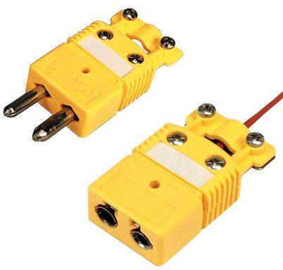

I am trying to make some K-type thermocouples. I have wire. Is it okay to twist the ends together at the sensing tip? There is no tension in the wires, so is it okay? I don't see why everyone says to weld them or solder them.
I don't have a welder and the solder won't stick (yes I used flux).
Crimp them with some kind of crimp-style connector.
You'll get by for some time with twisting them .
Cut off the part that has solder on it.
There exist nickel crimps for that purposehere's the best place i know of for thermocouple accessories.
And a good introduction to them.

but i didn't find those crimps.
