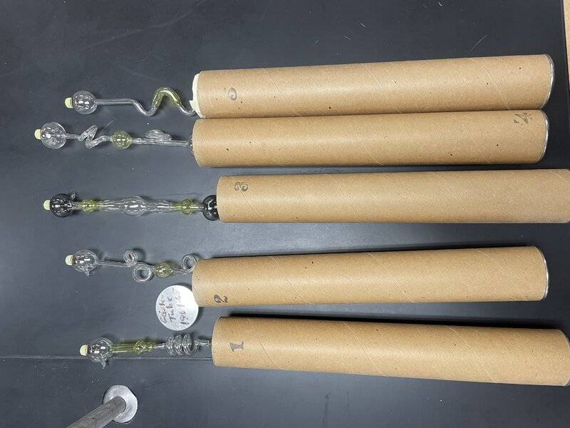

I've been searching for a way to ID the gases in a set of old (1964-1965), unlabeled Geissler tubes at our school. We have no good way of trying to light them anymore. They are in the original, numbered cardboard tubes but have no other identifiers. It seems like we should be able to match the shapes to a gas but I haven't had luck finding a key for that. They do contain uranium glass. Can anyone help us out?

Honestly, mostly I'm just curious. However, if I need to dispose of them properly I'll need to know. I intend to use them to demonstrate radioactivity for my 9th graders this year. If we can safely keep them at the school, I'll probably continue to use them for earth science and astronomy as "Hey, look at what this cool old thing could do!"

Thank you. Sorry it took so long to get this updated! The first week of classes gets busy.

The greenish colored glass contains uranium. I can't demonstrate these particular ones as they were meant to be used but can use online images and use the newer single gas bulbs to show the spectral lines when we discuss electron motion and emission spectra. I for now, I'll demonstrate how our Geiger counter reacts to various materials.

So, if we were able to tell you (somehow) what gas is in the tube, it wouldn't really help. Apart from everything else, it's filled with gas - probably less than a gram.
If you want radioactive things, go with the classics: lantern mantles, thoriated welding rods, salt substitute/road salt, etc. Fiestaware is not so easy to find these days, and granite countertops - even scraps - can get expensive. I would not be messing with tubes you can't light.
You should also look into a program called QuatkNet, where you will have the opportunity to build a detector suitable for cosmic rays, with an elementary coincidence circuit. Most people don't understand that a major source of natural radioactivity is the sky.
1) it's common for gas discharge tubes to have a radioactive component, it helps them to strike at a lower voltage - see wikipedia on neon bulbs which use Krypton-85. In this case they don't want the extra spectral lines, and have used doped glass.
2) Can't get them to light? - try cranking-up the HT voltage towards 10kV, 20kV even, if you dare.
3) Make sure there is a (HV-rated) series resistor to limit the current to [1-10mA].
4) or use a string of resistors to meet the HV spec, you could go 2x over the rated voltage, per resistor, for infrequent and monitored usage.
5) build the resistor string in mid-air, no substrate, PCB, paxolin or anything.
6) be bloody careful - but hey, you are a physics teacher and should know HV experimental safety
Even if the tubes have gone a bit "soft", you should still see something. If they've leaked all their vacuum to ambient pressure then they'll never light, but may find use as a Geiger source. As a last-ditch attempt, maybe try them with a Van de Graaf generator or a Tesla coil - with resistors and behind safety glass.
