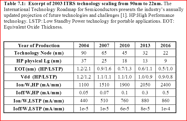

Why would low ratio cost more to run? Typical low power Ion/Ioff is 1000 mA/mm and 1E-4 mA/mm
As mentioned before, you can have low loss and low drive current. Losses aren't necessarily an issue if both off state and on state have low current.
That is, your Ion is 1E-3 mA/mm and Ioff is 1E-4mA/mm
This is much lower power if you want to compare thermals.
The question then becomes, why is this on/off ratio insufficient? What are the limitations? Is there a cutoff point when the ratio becomes reasonable for logic applications?
What does this mean? I don't understand your units...

I said please see Table 7.1. I chose the units and values based on what is quoted from the ITRS. It's just an example to get at the heart of my question.
Going from what you said, yes, why not have an Ion of 10 nanoamps and Ioff of 1 nanoamp. The fundamental inquiry is the same.
Is this on/off ratio insufficient? Why and what are the limitations? Is there a cutoff point when the ratio becomes reasonable for logic applications?
Oops, apologies, I missed that. So that table is on Page 2 of the document:
So you slightly mis-quoted it. The units of Ion/W are mA/mm. So it's a measure of current versus channel width, it would seem.

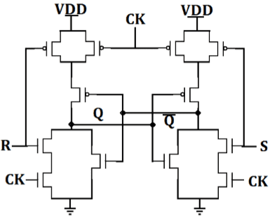

So here is a simple CMOS building block. Can you say a bit about what it is, and what it is used for? Also, as you lower the Ion value closer to the leakage current Ileak, what kinds of limiting factors can you envision? (assuming very slow operation like you were asking about)
https://www.tutorialspoint.com/vlsi_design/images/implementation_of_clocked_nor.jpg
