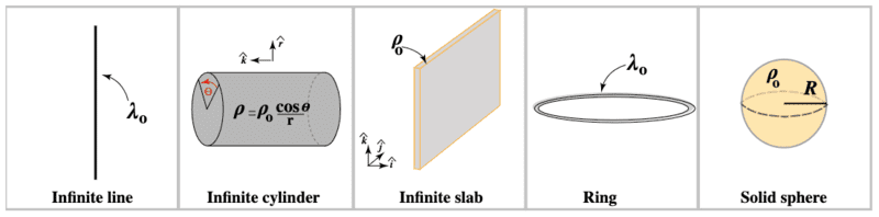

The title of this section is "Charge Distributions with Enough Symmetry for Gauss's Law"
The problem is stated as follows:
On which of the objects shown in the figure above can you apply Gauss's Lw to find the Electric Field from the given charge density? (Choose all that apply, see picture below)
1. Infinite line of charge with a uniform charge density ##\lambda_0##
2. Infinite cylinder of charge with charge density ##\rho=\rho_0\frac{\cos{\theta}}{r}##
3. A slab of charge, infinite in ##y## an ##z## with a constant charge density ##\rho##
4. A ring of charge with uniform charge density ##\lambda_0##
5. A sphere with uniform charge density ##\rho_0##
As far as I can tell, you could in theory apply Gauss's Law to any of the objects in the figure below. This answer, according to the automated answer from MIT Open Library, is incorrect.
Calculating the flux of the electric field generated by a charge distribution can be made easier or harder depending on the Gaussian surface chosen. However, as long as we can calculate the flux of the electric field through a closed surface, we can apply Gauss's Law. Is this true?
In the case of the infinite line and cylinder, we use as Gaussian surface a cylinder with end-caps perpendicular to the line or cylinder.
For the infinite slab, we can use a cylinder with the shaft of the cylinder perpendicular to the slab.
For the ring, we could use a piece of a torus around a small piece of the ring.
For the solid sphere we use an enclosing sphere.
What am I missing?
I also don't get the title of the section: "Charge distributions with enough symmetry for Gauss's Law".
I thought Gauss's Law was valid for any closed surface enclosing a charge. I don't understand what "enough symmetry" means in the title above. I get that with symmetry it's easier to solve the integrals involved by hand.
Gauss' law is always true. But, unless there is enough symmetry, you won't be able to use Gauss' law to find the electric field.
"Enough symmetry"usually means that you can choose a Gaussian surface such that ##\oint \mathbf E \cdot \mathbf {dA} =EA##
or you can choose a Gaussian surface such that ##\int \mathbf E \cdot \mathbf {dA} = EA## for some parts of the surface and ##\int \mathbf E \cdot \mathbf {dA} =0## for the other parts of the surface.

I’ll add a few words to what @TSny ny has said.
Yes, Gauss’s Law (GL) is valid. But that doesn't mean it can always be used to find electric field.
GL only gives the total flux passing through a Gaussian surface (S) in terms of the enclosed charge.
GL can’t give you the field at each point on S except in special cases - where the magnitude of the field is known to be constant (or zero) over each part of S.
For example, consider the ring of charge (radius R). In the plane of the ring, the magnitude of the field at R-ΔR (from the centre) is not the same as the magnitude of the field at R+ΔRE.
In fact, inside the ring, you should be able to see that the field at the centre is zero. But outside the ring, you have to go to infinity before the field drops to zero.
So:
“For the ring, we could use a piece of a torus around a small piece of the ring. “
won’t work because we have no way to deal with ##\oint E \cdot dA## since ##E## is not constant.

In your first post you wrote
Yes, that's right. But keep in mind that there's a difference between calculating the flux and calculating the field E.
It depends on what you mean by "apply". In this problem, you want to apply Gauss' law to find the electric field produced by the charge distribution. Unless there is enough symmetry, it will be impossible to apply Gauss' law to find E.
Yes, but it is essential that the linear charge density is uniform. If the charge density is nonuniform, then it would generally be impossible to apply Gauss' law to find E.
Yes. But if the slab has a nonuniform charge density ##\rho##, it will generally be impossible to find E by application of Gauss' law.
Have you been able to do this? What expression did you get for E?

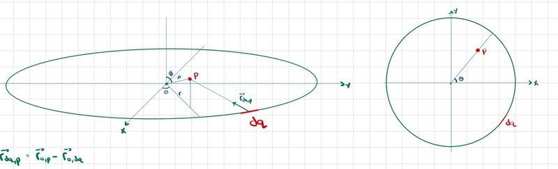

I tried to do it just now. Seems pretty intractable for me from the point of view of calculating the integrals, as far as I did it.
My strategy was:
- Use Coulomb's law to find the electric field generated by the ring at any point ##P##. If I have this then I have an expression to use in a calculation of flux through a Gaussian surface around a piece of the ring.
- First I used Coulomb's law for a ##dq## on the ring.
$$\vec{r}_{dq,p}=\vec{r}_{o,p}-\vec{r}_{o,dq}$$
$$\vec{r}_{o,p}=r_p \hat{r_p} + \rho \cos{\phi_p}\hat{k} = r_p(\cos{\theta_p} \hat{i} + \sin{\theta_p} \hat{j}) + \rho \cos{\phi_p}\hat{k}$$
$$\vec{r}_{o,dq}=R\hat{r}_{dq} = R(\cos{\theta_{dq}}\hat{i}+\sin{\theta_{dq}}\hat{j})$$
$$\vec{r}_{dq,p}=r_p \hat{r_p} + \rho \cos{\phi_p}\hat{k} - R\hat{r}_{dq} $$
$$=(r\cos{\theta_p}-R\cos{\theta_{dq}})\hat{i}+(r\sin{\theta_p}-R\sin{\theta_{dq}})\hat{j}+\rho\cos{\phi_p}\hat{k}$$
Note that ##\vec{r}_{o,p}## doesn't change, but ##\vec{r}_{o,dq}## changes as we change ##\theta_{dq}## from ##0## to ##2\pi##, ie ##\hat{r}_{dq}## changes.
$$dq=\lambda ds = \lambda R d\theta_{dq}$$
$$dE_{dq,p}=\frac{k_edq}{|\vec{r}_{dq,p}|^3}\vec{r}_{dq,p}=\frac{k_e\lambda R d\theta_{dq}}{|\vec{r}_{dq,p}|^3}\vec{r}_{dq,p}$$
If we now sub in ##\vec{r}_{dq,p}## and ##|\vec{r}_{dq,p}|^3## and take the limit of a Riemann sum, we get an integral in ##d\theta_{dq}##, from ##\theta_p## to ##\theta_p+2\pi##. A quick try on Maple of one of the integrals shows a crazy result.
Before I dive in and try to figure out if there is a way to solve the integral, maybe you guys have more experience and can tell me what you think so far, if there is a coordinate system in which the integral might be easier, etc.
At this point, I feel like I should've placed point P above one of the axes ##x## or ##y##. This would make all the ##\theta_p## expressions simpler. But actually it only simplifies things slightly.

You are asked to decide if you can use Gauss' law to determine the electric field at any point ##P## (without using Coulomb's law).
Is there a way to choose a closed surface that passes through the point ##P## such that you can set up the equation ##\oint \vec E \cdot \vec {dA} = \frac{Q_{enc}}{\epsilon_0}## for this surface and then solve this equation for ##E## at point ##P##?

I think you are missing the point – applying GL simply can not provide you with E as a function of ρ and θ.
The integral from θₚ to θₚ+2π is independent of θₚ. You must get the same answer whatever value of θₚ you use because of Gauss’s Law! - the total flux through the Gaussian surface is the same whatever angle you start/end at when evaluating the integral.
The integration will remove θₚ from the result – so you will end up with no information about the dependence of E on θ.
GL is valid here but simply can’t be used to find E as a function of ρ and θ.

Ok, looks like I did miss the point. I was trying to use Coulomb's law to calculate the electric field at an arbitrary point P, to then use Gauss's law. But for what? The point of GL is to have a way to calculate the electric field at any point using a surface integral. If you already have an expression for the electric field, then using Gauss law would only be useful if you somehow didn't know the enclosed charge somewhere. You could use GL to solve for that enclosed charge.
Indeed.
TSny said:
Is there a way to choose a closed surface that passes through the point P such that you can set up the equation
Looks like the answer is no, because the surface integral contains the expression for some non-constant electric field generated by the ring. I guess this is the point of the Gaussian surface being symmetric enough: symmetric enough that the electric field is constant on the surface you are integrating on.
