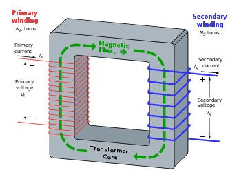

Try visualizing a simple transformer like this one.
When secondary is open, it might as well not be there and you have an inductor, which you just studied in another thread. So build on that.
Diagram of a transformer with a laminated core, a primary winding on the left and a secondary winding on the right, with a dashed green magnetic flux loop around the core and labeled currents and voltages.

Now - when current flows in secondary, it'll make an opposing MMF that pushes back against primary MMF.
So you get opposing MMF's.
So , flux would begin to drop, reducing counter EMF in primary
so more primary current would flow
restoring flux to a value that'll balance applied voltage at new current.
Note that with secondary shorted the currents can be quite large, so some of applied voltage makes IR drop in primary instead of induction, so flux will be a little lower. Power will be dissipated in the windings in unusual amounts, so conservation will not be a straightforward approach. You have huge MMF's opposing one another so leakage flux will go up.
So the answer to your question is - i think you should think in terms of what are the internal processes. That'll make the equations intuitive.Be aware that there exist transformers that operate at very low voltages, with current in the primary set by something external.
In those transformers flux is kept quite low by assuring that secondary is very nearly shorted. That's up to the user to guarantee.
Since primary current is set externally , only enough secondary current will flow to cancel primary amp-turns..
Primary and secondary amp-turns are almost exactly equal so very nearly cancel, keeping flux low..
They're called Current Transformers and you'll get to them later.
That's why it is important to be aware of what's going on in the iron core.
Train your mind to push flux around imaginary cores. I was baffled by current transformers for a long time, until i finally learned my magnetic units and started pushing flux...old jim

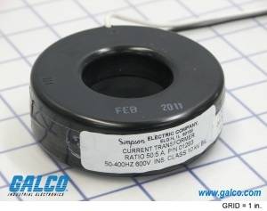

  • Black toroidal current transformer with a white lead exiting the side; label reads Simpson Electric Company, Current Transformer, Ratio 50:5 A, 50-400HZ 600V, UL Class 1 Div, with 'FEB 2011' scribbled on the body.

A CT has its primary connected in series with a load whose current we wish to measure, like a motor or transformer or lamp or something.
So the amp-turns in primary are determined by that load and the number of turns on the CT.
Many CT's are built like a donut with the current to be measured flowing through the donut hole, in the wire going to the load.. That's a one turn primary.
Black toroidal current transformer with a central hole, labelled Simpson Electric Company, Current Transformer, Ratio 50:5 A, 50-400Hz 600V, and a date stamp FEB 2011.
You'd route a wire to load through the center. A stepped down current will be available in the secondary that can drive a small meter.

But what happens if you shorted the secondary on a CT? I imagine it would still be quite small, but the reason I ask is I'm wondering about how to calculate the current from the turns ratio of the CT. Would the voltage of the single turn primary be the difference between source to load? (Which is arround the CT as the wire passes through it from source to load) Just seems quite different to how I would think of a CT voltage-turns ratio.Another top post (Old) Jim! ;)
CT's are operated differently than voltage transformers. They're still just transformers.
The difference is only in how we use them.
Remember from several poosts ago
amp-turns in secondary cancel amp-turns from primary
so those few primary amp-turns will cause modest mmf,
which will cause modest flux
which will induce modest voltage in secondary ,causing just enough voltage to push current in the amount required to cancel nearly all those primary amp-turns.
If secondary is shorted that takes but very very little voltage.
You're left with a transformer that's not working hard at all. Flux is low, current isn't out of control.
Now the counter emf induced in primary will be small because flux is small.
Current transformers are designed to operate with low flux and small voltages.
Therefore they must an have excellent core that'll pass flux with small mmf, remember mmf seen by the core is sum of amp-turns from both primary and secondary. The idea is to have those as nearly equal as possible.
What is dangerous to a CT is an OPEN secondary and here's why:
With secondary open you have no secondary amp-turns to keep flux low.
So, if there's much primary current at all, (remember something else controls that not the CT,)
the flux goes way up 'cause secondary doesn't cancel primary mmf..
IF the core saturates, which it can because it's so good, , flux will swing between positive and negative saturation.
That'll be sudden snaps not the smooth cosine wave flux we like to see..
Think about Voltage induced in the open secondary , where there's lots more turns:
during those 'snaps' it can become great enough to puncture the insulation.
That's why you NEVER allow a CT's secondary to become open while there's primary current.
It can hurt you and wreck equipment including itself.
In days of vacuum tube hi fi amplifiers the same applied to the speaker outputs, for tube amps have transformer output (see RCA Tube Manual)
so you always made sure your speaker is working before turning up the volume. Better sets had a 100 ohm resistor permanently soldered in across the amp's speaker terminals to protect the transformer from "OOOPS's".
So the current transformer seems weird but all it is is an excellent transformer with a high permeability core.
The difference lies in how we operate it.
I'm really glad you asked about CT's . When you get your head around them you have made a lot of progress in magnetics.
