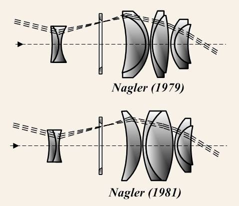

Let's start with a simple example. You want a single 'star' to appear as if it is an infinite distance away. This would be as simple as placing the light source at the focal point of a positive lens, which causes the emitted light to exit the lens parallel to itself, making its apparent distance infinite.
The problem you're faced with is how to scale something like this up to a large size and to a rather wide viewing angle. Telescopes also make things appear at an infinite distance away and can achieve greater than a 100 degree viewing angle with expensive eyepieces, but they are limited to small eyepieces that sort of 'wrap around' the viewers eye (see how the rightmost lens in the diagram below is concave, with the observers eye looking left). An example of this is the Nagler eyepiece design, shown here:
